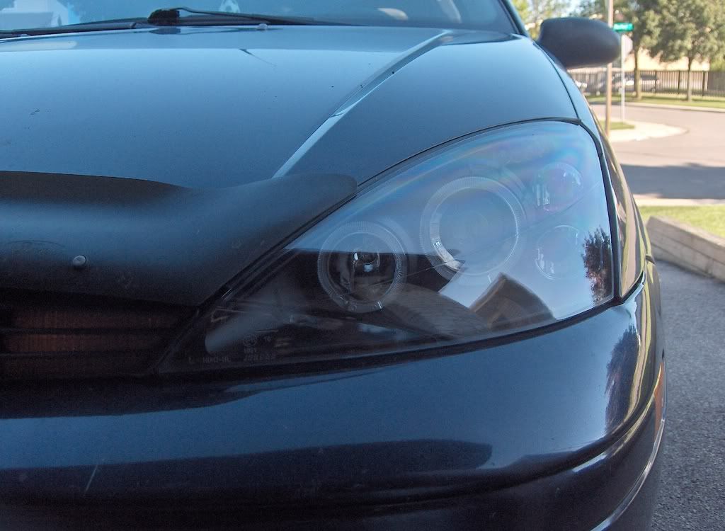

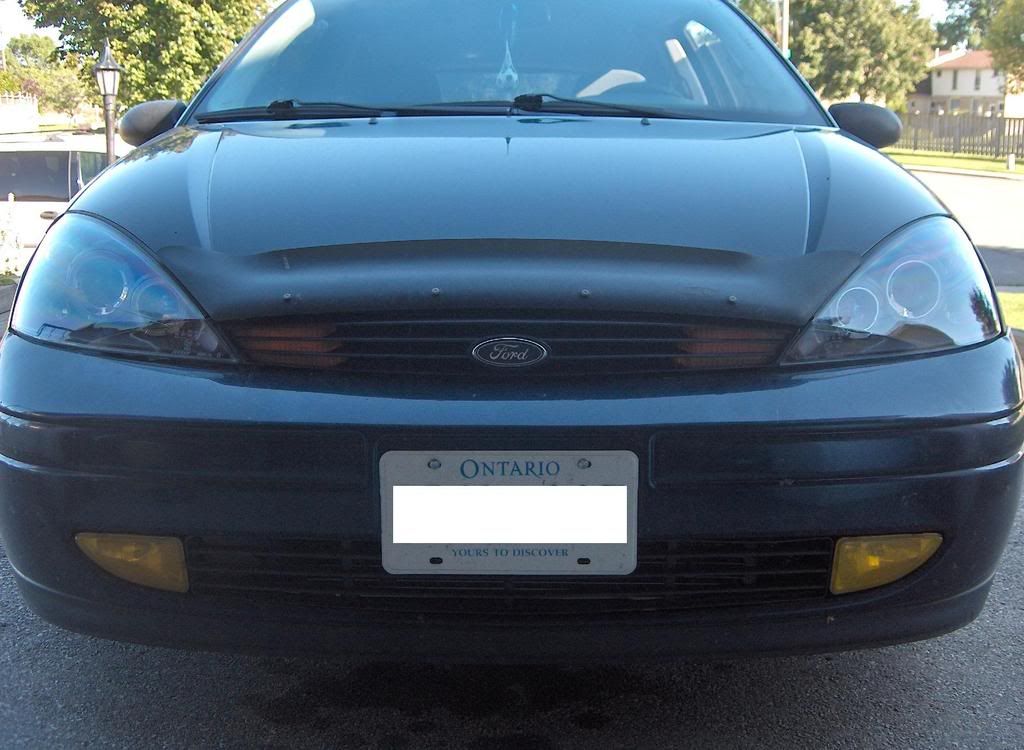

hey guys got my new lights in today letme know what you think so far
WARNING:car is EXTREMLY dirty... so dont tell me sumthing i know
here they are before there in
heres a shot of my ugly sun damaged stock lights with the new and improved :D
and installed
thanks for looking

i have the same lights and love them...fyi though if you want to put HID's in them you can the cut off line will be fine but it might not illuminate the road very well...you might have some dark spots...but it's different from headlight to headlight.
1,653 Posts
Mach-a-likes! Yep, they look good, but do adjust them. A friend of mine had a pair and, unadjusted, they were a bit scary.
looks good man. my friend just got his headlights like that installed
