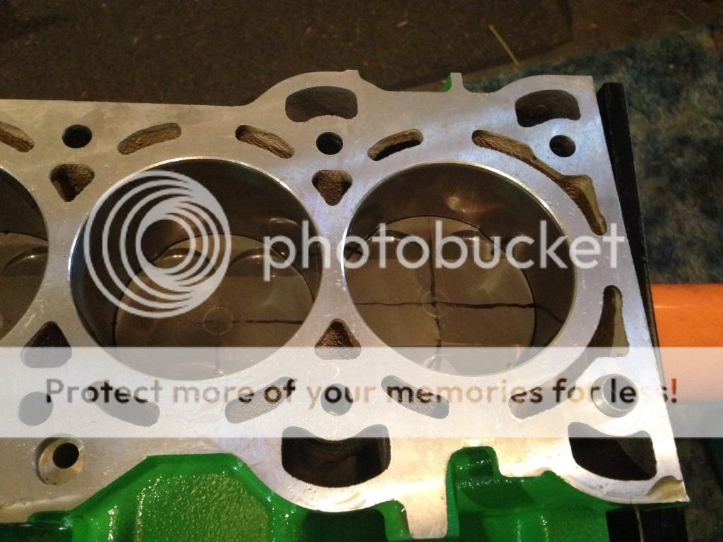

I have the short block put together and am going to install the head later on this week pending upon my valve to piston clearance and final cylinder compression numbers. This is my first build and I have done most everything myself with thorough research! Although Nate did help me finish pulling my old motor.
I have a few pictures but to be honest, I didn't take many as I am not a picture type person.
The motor is going lime green/ massive purple... Hulk theme (the lime green is much nicer in person and trust me, I meticulously prepped this thing so fingers crossed it holds up)

I will try and lock in something somewhat soon. I ran into a slight issue while I was calculating my final compression numbers. It looks like I am at 13.5:1. lol way too high. To lower this I need to increase the volume in the combustion chamber and toss on a thicker cometic head gasket.
I wish I could run that much compression but the majority of my build does not support that type of power; not to mention I refuse to drive to Auburn to fill up on 100 octane every time I need gas.
Either way I will have to order a Cometic gasket that will take a while to get to my door!

So I got my cometic hg in the mail today. Still waiting on Cossie timing stuff and then its install time. Dont know when that will be though.
