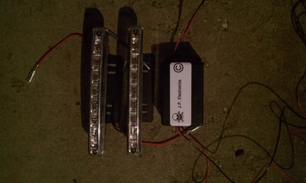

I seen another member put some DRL leds on his car and i thought they looked pretty sharp. So i decided that i was going to do the same but i made a circuit so they are on all the time and didnt want to spend $200. I plan on installing them this weekend. If it all works out i might be willing to make some more kits for people if anyone is interested. I will upload pics when im done.

So I finished installing them this weekend. Works perfect turn on when car is running and turn off when car is turn off :) Thanks for the great idea.

My circuit that i made was flawed, they must have a clutch that limits the voltage coming out of the alternator. I noticed my lights were off when i was driving. So I found a OBD 2 cable sitting around the lab and connected it to a voltage meter, used the VBATT and ground. Watched it the whole way home. At 70 mph steady I was getting 12.89v and it would jump when the a/c compressor would turn on. it changes a lot as i was driving, 12.6-14v. When you really get on the car it drops down to what seems to be battery voltage 12.6 volts. So i got a relay and connected it one of the empty spots in the fuse box under the hood and used it to power the coil on the relay to close it when the key is on and car is running. Seems to be working fine now.
