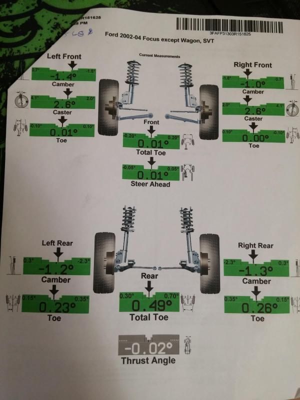

Hey guys I had an alignment done on 6/23/14 and at the time had noticed my 2 front tires' inside tread was going bald while the rest of the tire was fine. I also had the tires rotated and wheels balanced the same day as well. When they were done, they told me one of the wheels was bent but everything else was good. I drove the car for the next 6 months and noticed the other 2 tires' inside tread was going bald as well... so I finally bought some new wheels and tires on 12/4/14 so it hasn't been too long. I took it to a shop that the tire place referred me to to have them just do a visual inspection of everything to see if I need to worry about the insides of my new tires' tread. Obviously, he didn't put it on the alignment rack, so I don't have any numbers from today, but I do have the numbers from the alignment 6 months ago below. The guy I was talking with was telling me about the camber/caster plates for the front, since they are nonadjustable without them, which I learned today. What do you guys think?
nevermind the "SVT" part, it's a ZX3. I also don't know if the suspension is the SVT hardware or not. To me, the car looks a bit lowered.

That chart doesn't look bad, if you're having wear problems up front look at the bushings for the lower arms. If they're sloppy the angles could change while driving.

I had to put the camber plates on up front, and the camber bolt kit for the rears. Completely cured my abnormal tire wear. But I agree with sailor, your specs from 6 months ago don't look that bad. With that being said, I had mine set for zero camber up front and less than -1 in the rear.
