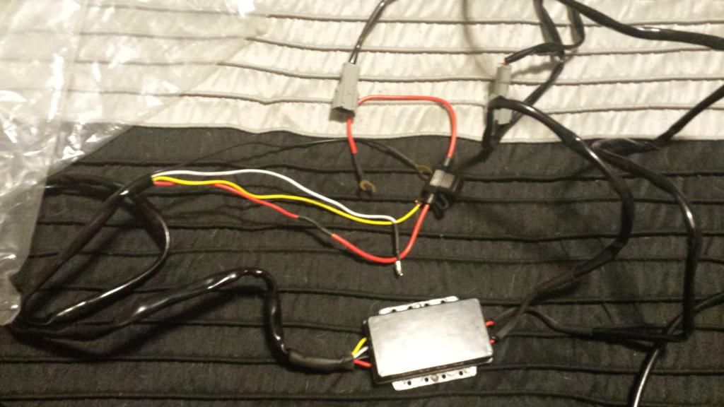

Your wiring looks slightly different from mine but it looks like we both have the red/black, white and yellow wires.
here is what I did:
white wire to pin 10 on the headlight
yellow wire into the fuse F42 for the rear wiper
red wire to battery
black wire to ground
I had to trim the plastic bumper supports behind the bumper. They were pushing my DRL triangles out. The took about 3/4 to 1 inch off.

Would anyone have a picture white wire to pin 10 on the headlight and how he made the connection yellow wire into the fuse F42 for the rear wiper? I'm having trouble ...
1,010 Posts
You will need a fuse tap for the yellow wire and the white wire isn't necessary unless you want them to slightly dim when the headlights come on, but you can use a 3M wire tap for that.
