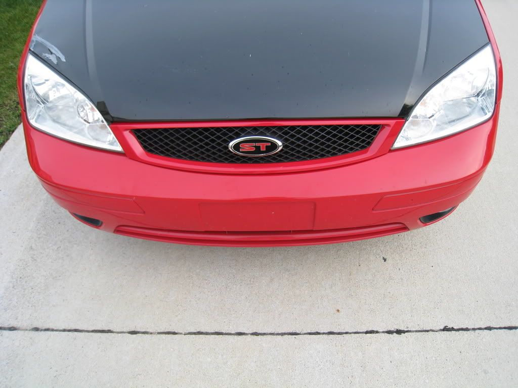

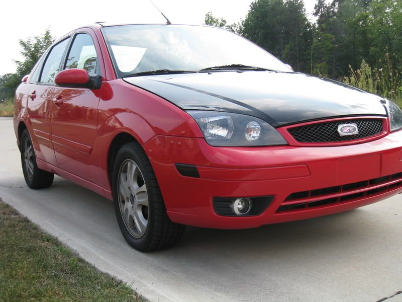

I just picked up some bondo and primer. I'm sick of waiting for my cf hood so I decided to paint the sides of mine. Has anyone ever done this, any tips. I have never worked with bondo, but I read up on it so...I should be able to handle it. I'm just afraid of what it will look like once I put on the can of spray color match paint and can of spray clear coat. But either way, I’m committed now, $20 spent…lol
So my main question is where should I cut off the red and start the black. I want to use the contour lines so there is only two places to have the paint stop. Let me know what you think.
If anyone wants to photoshop for a rep point I'll give you one!

That looks good and I bet it would be killer with the black headlights! Okay, I'm glad I'm doing this. Maybe this will turn into my winter hood!

Both got rep points, anyway, can anyone photoshop it on the outside line?

well let me give you some advice on bondo, put more than you need on and take it down to what you need. this helps get the shape of the area your doing. also use some type of block as you are doing a flater area. once you have it filled and primed ( i like the filler primer) get the hose and let the water run over the area so you can see if there are any waves or such.
and on the painting of the stripe, you will get an edge where the tape lays so use the inside line where the hood is lowest that way no one will be able to fell the edge of paint. if you do get a light edge rubbing compound will help smooth it out. and also if you get an orange peel in the paint job rubbing compound will help there too.

Can anyone photoshop one of the other pics? I want to see what it will look like with the black lights.
ill PS them now.... but whats the bondo for if your painting? is the hood damaged?

First off, bondo should never be thicker then a 1/4" or you risk cracking.
And that color matched paint isn't going to be exact, in fact it may be a big noticable difference, especially on a red car. You can get your paint code in a can, but you'll also need to know exactly where your car was painted because colors actually very based on region. Sounds crazy, I know.
But it sounds like you just want to do this until you get your CF hood, so go for it. It'll be a fun learning experience I bet.

It doesn't seem to look as good on an 05 as it does on an 00-04.
The hood lines just don't flow the same.
Maybe seeing it actually done would change my mind though.
