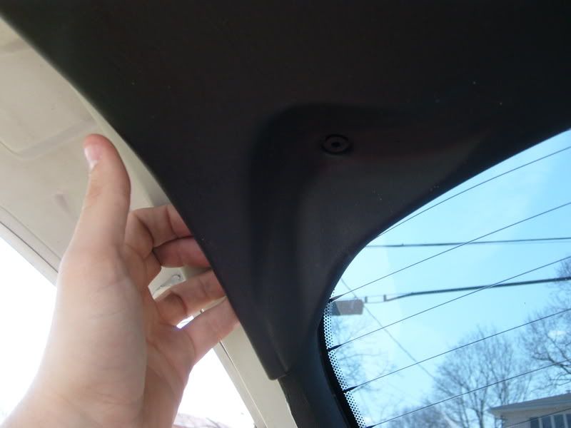

Start by opening your hatch, locating all 4 screws. Each side has 2 screws, pictured like this:
After removing all 4 screws, you will see small screw caps inside the holes. These will try to come out as you start pulling down on the hatch, so be careful.
The way I conquered the hatch panel was by pulling down forcefully on all 4 corners. Remember about those caps.

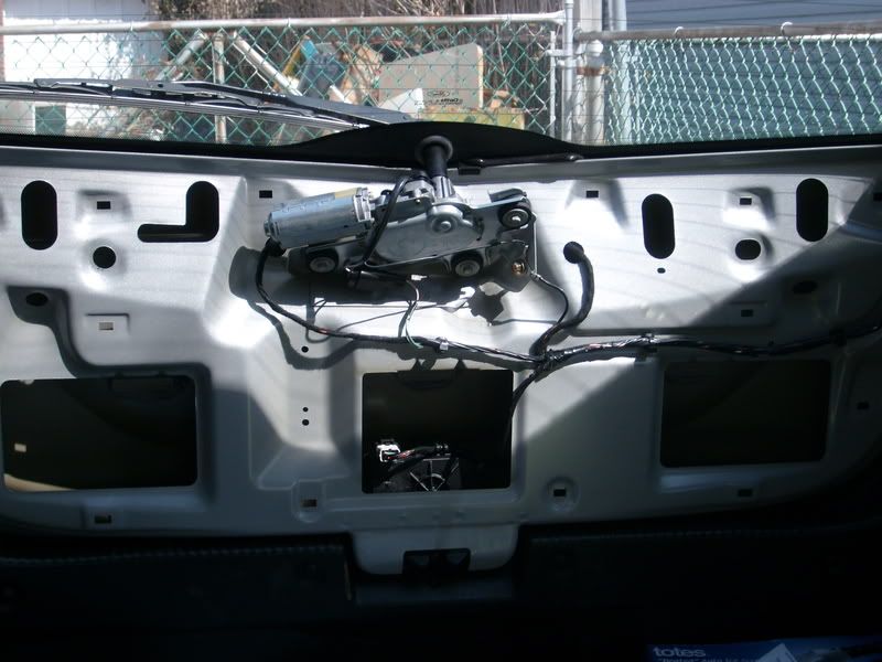

Once the panel comes off, this is what the inside part of the plastic panel, plus the inside part of the bare hatch now look like:

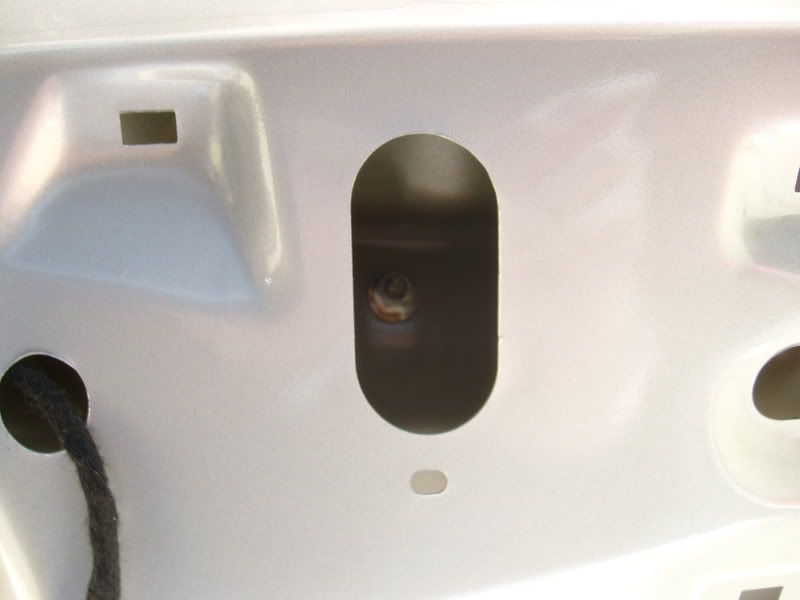

There are five 10mm nuts that need to be removed. Four are very visible, with holes revealing their positions, while one is hidden behind the wiper motor.
My screwdriver allowed a 10mm socket to go on, which was the EASIEST way I could imagine doing it. I couldn't imagine doing this with a socket wrench.

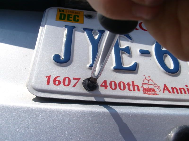

To get the strip off, I had to remove my license plate, but that was nothing more than 4 flat head screws.

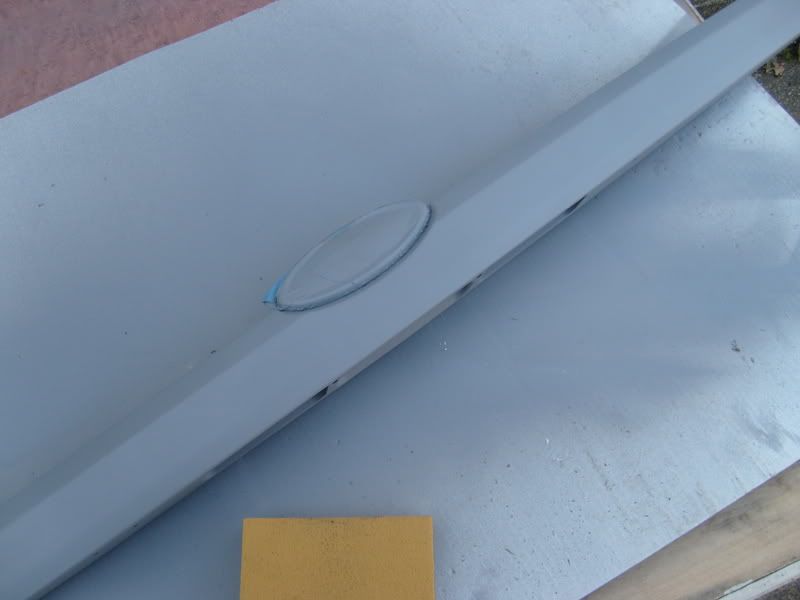

Tape off the Ford emblem with painter's tape and place your trim strip on a nice stable surface, and give it a nice wash and dry to remove any surface blemishes.
Once dried, give the strip a nice sanding, to remove any blemishes that could show up in the paint. Be sure to scratch the surface up properly, since the primer is going to need to stick to the plastic.
Be sure to take your time, and you will end up with a trim strip looking like how mine came out:
