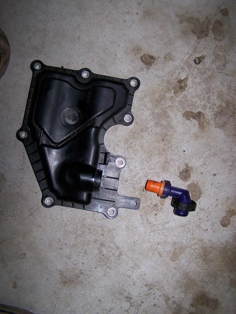

The next thing you will need to do is remove the plate that holds the PCV valve, it is located on the block underneath the 2nd and 3rd intake ports in the photo, it has the little purple fitting. There are 8 bolts holding it to the block.
Step 3 - Remove PCV valve from Block plate
After you have the plate removed from the block you need to take the PCV valve out of the plate. There is a little black ring that retains it in the plate and you will see 2 small notches in the black ring. Use a small screwdriver and VERY carefully pry the notches away until the ring comes straight up. After you get the ring off you simply pull the valve out of the plate housing. Here is a pic of the plate off with the valve removed, you can see the little black ring near the end of the purple valve.

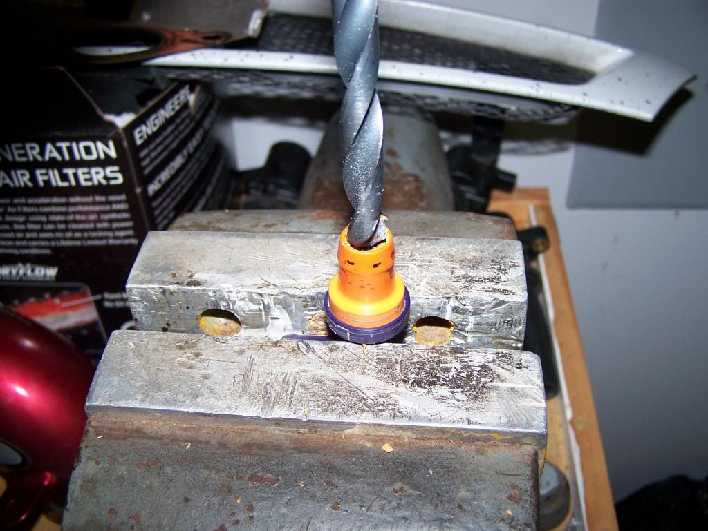

Once you have the valve removed from the plate its time to get the actual "valve" part of it out. There are a couple ways to do this, my pictures will show the way I did it but there are also markings I put on the valve to assist in the other option as well.
Option 1 - Cut the bottom of the valve off until the lip that holds the plunger in is removed, once it is gone the spring and plunger will fall right out. There are small black lines in my picture on the orange part of the valve, that is about how much you need to cut off the end to get the plunger to fall out.

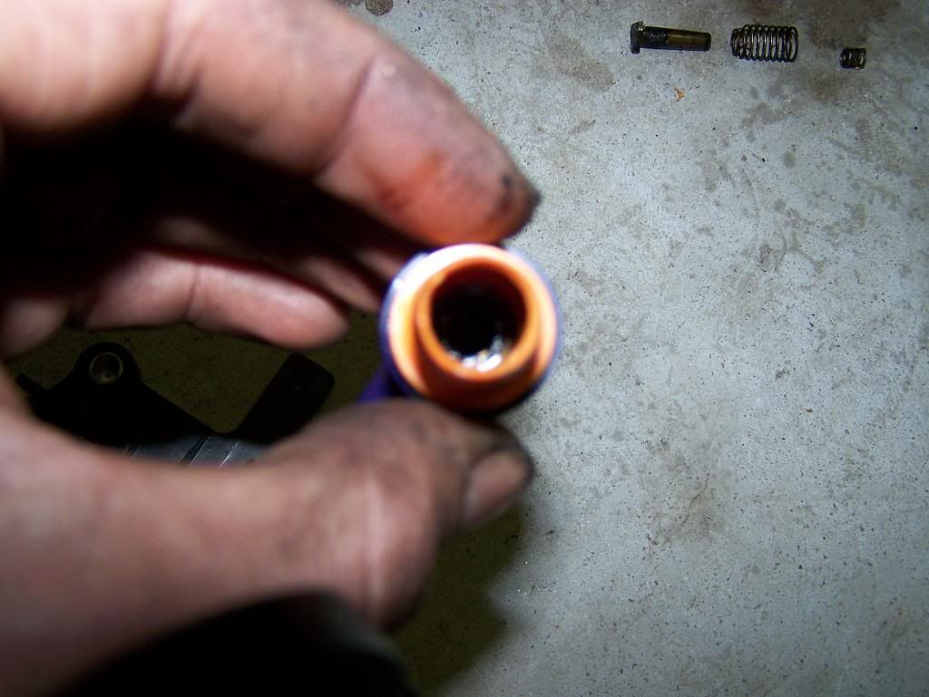

Option 2 - Drill out the bottom of the valve until the lip is removed, I used a 3/8" drill bit and it was ALMOST perfect, I had to use a razor blade to grind off the tiny bit of the lip until the plunger fell out. Be very careful using this method since you are drilling into pretty thin plastic, you don't want the drill bit to bind up and crack the plastic. The only real benefit of doing it this way is that you aren't shortening anything other than that there is no real benefit from one method or the other.
Here are a few pics showing the valve being drilled, you can see the black lines I marked in case you want to simply cut the end off.

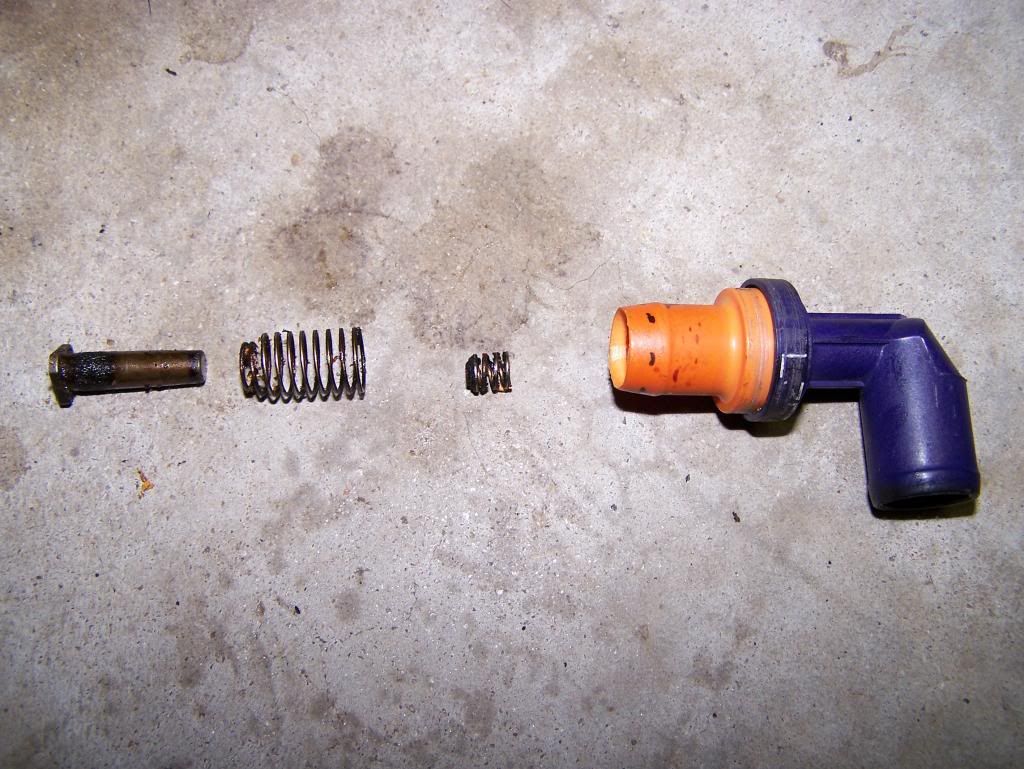

Here is a pic with everything removed, this is the order it will come out of the valve as well.
