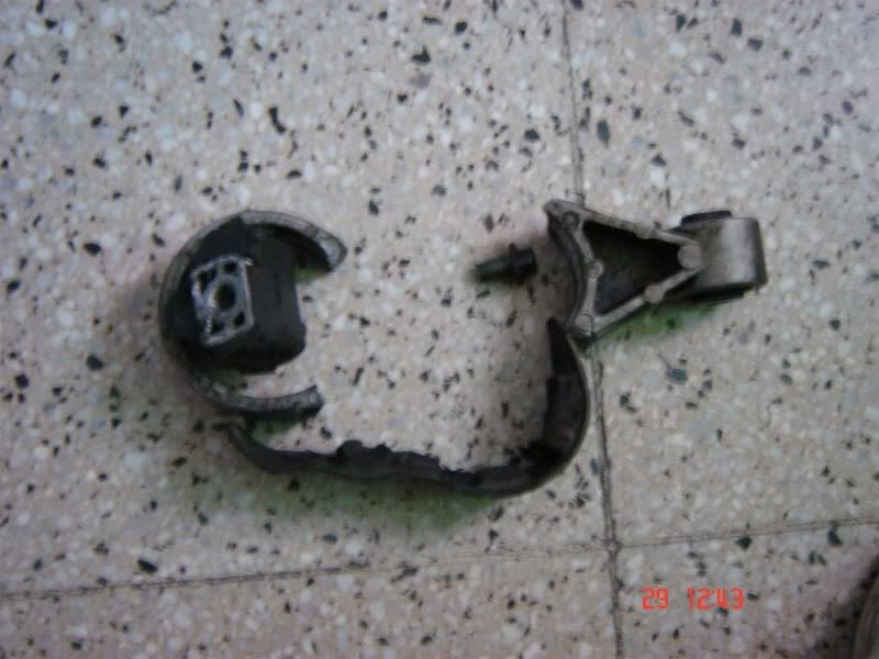

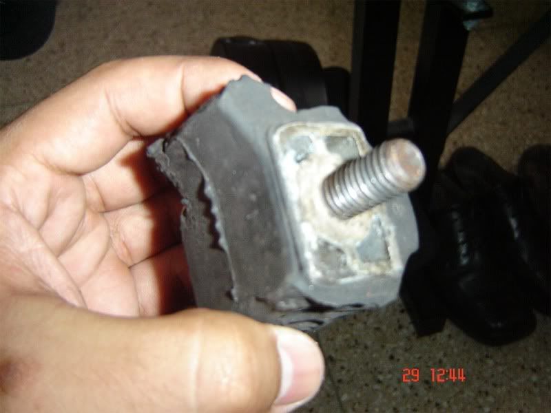

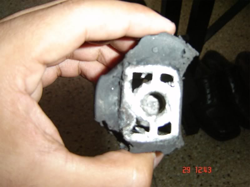

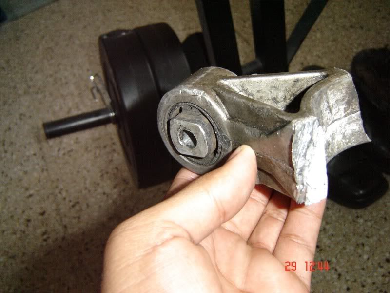

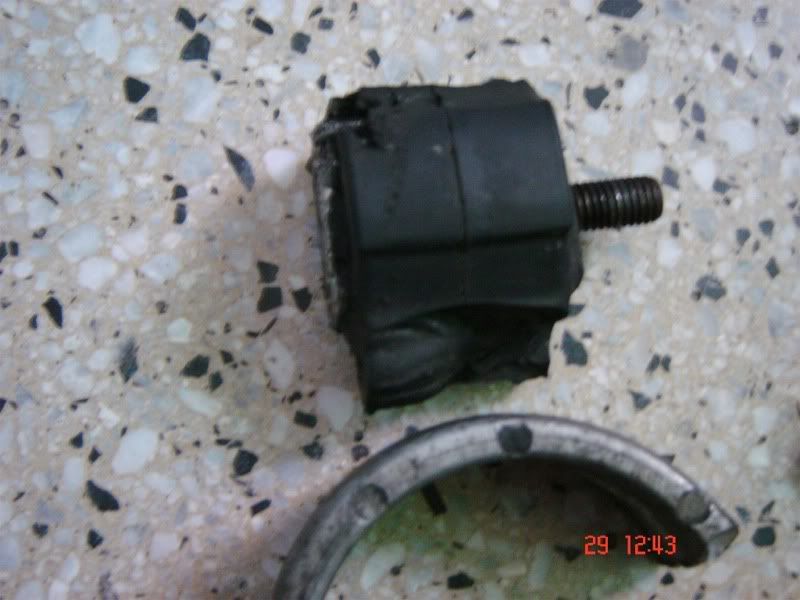

Well, i bought my used ZX3/01 on oct/05, it has now 82k+miles on it, but i'm sure the previous owner didn't gave a shi$%^ about the cars maintenance, all the mods that i have installed on the car have been a ride in the park, no way jose, all the bolts have been really rusted, all parts have been really sticked and messed up, but yesterday was just it... i decided to change the engine mount (lower one) cuz i was really pissed off about all the cracking under the car, so i was just sure that the engine mount was the problem, so i got a new one and w/ a little of time on my schedule i decided to finally change it, i mean it was not really nice that a car that looks cool keeps rattling like mine did when i launch from first.
So anyway, i put my car on stands, supported the gearbox w/my jack and all the instruction people from this forum have puted together, and then what?? the lower bolt, was stuck!!!, i mean it really didn't turn at all, i said crap, they're supposed to have only 35lb*feet of torq, not this one, i had to took it apart the hard way, i took my dremell and saw both sides and beat the crap out of it till it was just a lot of pieces, you can check the photos they're really scary, right now the rattle is over and my ride is very smooth, but i tell you its better to put up your car now and then and give it a little wd40 on all bolts down there![}:)] Scary uhh?

very nice! Hey you did what had to be done you know? The new mount makes it run real nice huh?

Damn boca, you muscled thru that. The dremel is a handy little tool. You really busted your ass to get the mount in. Thats awesome.
