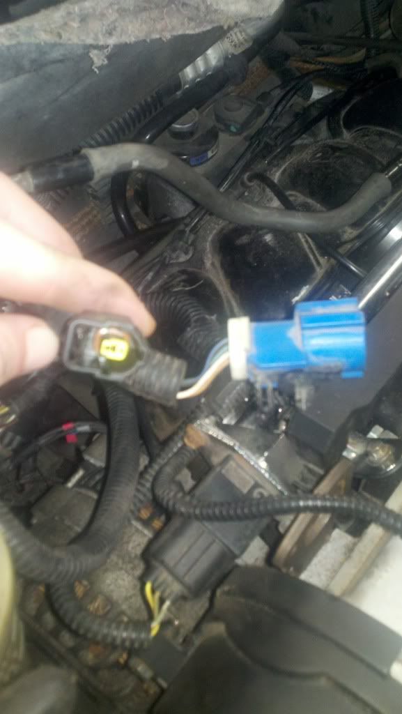

1 Wire:
Should be for the oil pressure sensor. It's just above and to the drivers side of the oil filter. Easiest to see and get to from under the car.
Blue Connector:
I'm not sure but, It looks like it could be for an O2 sensor.
Last pic / Knock Sensor:
Back side of the engine under the intake manifold.

thanks man! from the main power and ground to the battery what all gets connected to the starter/alternator?

Yup ^^ he's right. Blue is the rear o2 sensor
