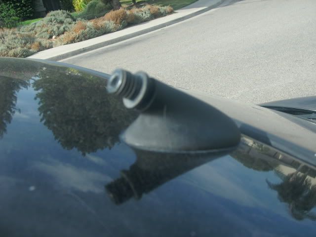

So i ordered a new antenna that should be here today, and i was gonna ask before i try to install the antenna and risk messing anything up if theres anything wrong with my antenna base. For some reason it looks different than any other focus one i have seen, it has this thereaded black plastic piece on the end? IS it supposed to be there? WHat is it? i havent seen this piece on any other focus antenna base please help.

See if the 'adapter' turns out.
The pic's on ebay of the Focus antenna base is how it should look to fit the factory or shorty antenna:
It's probably an adapter to fit an aftermarket antenna.
12 Posts
A lot of cheaper universal replacement antennas come with an assortment of adapters. This black plastic threaded piece appears to be one of these adapters. However, plastic isn't conductive. I'm betting it's another material that looks like plastic, and is slightly seized on to the metal threaded rod coming out of the antenna base.
Regardless, grab it with a pair of pliers and unscrew it!
1,543 Posts
Well, be more careful than that, the factory threaded stud is pretty weak. If it doesn't twist off easily, spray some penetrating lubricant into that hole at the end and give it some time to soak and work, looks like a perfect place for that.
