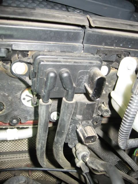

Can you get rid of this when you have a egr delete tune, if so what do you do with the vacuum line holes that go to the intake manifold? plug or does this thing need to stay on??

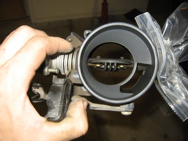

when porting the TB since i have it out, what do people do, i have epoxy i just dont understand what there porting on it. the butterfly?? intake manifold side?? top intake MAF tube side??? thanks for the help FF!!![ffrocks]

the way i deleted my egr was without a tune, with that said, i had to keep that DPFE sensor. im not positive but i think that if you delete your egr with a tune you could prob remove it with no probs.
what i did was i took the entire egr valve out and the metal pipes that connect it to the exhaust manifold. u can either make or buy a block-off plate for the intake manifold side, i made one myself but heres a link your ya. block-off plate so all that is left is to put a flare cap on the egr bung in the header/exhaust mani. i couldnt find the right thread pitch so i had mike(b16sir1991) send me one for my svt header. FYI he works at ford and if your a member of FF you get a discount!
i have also ported my stock TB. porting your stock TB this site has a lot of good info, but not as much as FFtho. here is the "how to" section of focus fanatics its really a gold mine of info!

alright so i can totally remove those 2 sensors that mount up by the firewall. and i can get rid of the selenoid thing on the back of the intake manifold? what about the egr tube that goes into the manifold?? i have it all apart right now and not sure what everyone is doing to these 2000 IM... thanks for those links!

what do you mean two sensors on the firewall? OH!! i see what your talking about now, and uhh to be honest im not to sure. i know for a fact that the top one is your DPFE sensor and you can take that out when you delete your egr.
do not take that IAC vavle out on the back of your IM! you need to have that in there so your engine will run properly, it has nothing to do with the egr.
usually people leave the metal pipe connecting the egr valve and the IM and just put a block off plate where the egr valve used to be. although i have heard of people putting quarters in between the IM and the egr tube, ive never tried it but some people say it works. the easiet way is to just use a block off plate tho.

ya i see about the block off plate, i want to remove the sensors that mount to the firewall. those are deleted in the egr delete tune right? and wont effect anything if i dont hook them up and stuff the connectors somewhere?
