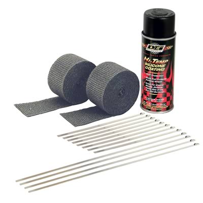

So I made the easy decision of wrapping my header. I was looking at two options, a DEI Kit with the wrap/ties/and High Temp. Silicone coating. or some Thermo Tec Clamp on heat shields. The latter is a little bit more expensive, but "looks" like a somewhat better system
DEI Kit

Has anyone here used the silicone coating on a header wrap before?

hmmm didnt even know it existed honestly, i just used header wrap from autozone 50 bucks for 50 feet i think....and 8 stainless steel hose clamps...one up top and one down bottom...

that silicone looks like something i should perhaps invest in, but does that just get sprayed over the heat wrap?

yeah, it protects it from water/dirt. Dirt being more of a problem than water here. The thermo-tec's go for around 20 bucks for a foot, 30 for 2 feet. And are 6 in wide. So it may take 3-4.

I went to eBay for my 2''X50' wrap, 10 12'' stainless steel ties, and black DEI spray. Cost me about $40 total, but well worth it and no issues.

I would definityly get the wrapp and the spray. I've had my header wrapped for a little over two years and did'nt spray it with the silicone spray stuff and they are now rotting off. ITs fine has long has you don't touch it. If you touch it then it just crumples into fine fine dust like particles. Really sucks when I work around it I got to wait for the air to clear or risk lung damage. So I say spray and wrap. the other stuff does'nt look too goo to me IMO. I mean it looks good but it would'nt be a tight wrapp all the way around the header keeping the heat in. I will say when I first did it my underhood temps were way way down. After driving the car and even running around in it hard you could put your hand on my valve cover (intake side of course) and leave it there thats how much cooler it was. I need to redo since its falling off now but it was one of the best mods I've done. And if I get a SVT thats what I'm going to do with its header.

Depends on which header you are wrapping when you determine how much you need. I only used half of a two inch wide roll on my F2. (25 ft i think it was) Because the primaries meet so soon. Whereas on the Cosworth kinda design it will take more as the primaries are kept much farther apart all the way down.
And yeah the silicon spray acts as a protectant from moisture and dirt. It also helps just hold the exhaust wrap together so it doesn't come loose and eventually fall off. Kinda a glue of sorts that keeps it all tight.
