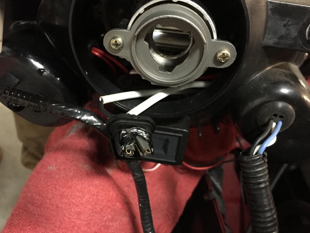

It's been a while since my last post, but I bought the halo projectors a couple years ago, and have been having issues the past couple months with them. One of the headlights stop working but the LEDS and halo rings worked. I initially thought it was a bad bulb but the bulb was fine, however, the connector was not secure. I fixed that. Both headlights worked for a while longer. Now both are lights are out but the other lighting still works. It's a pain to change bulbs out since you have to take the suckers out lol. I have found a issue that the connector is melted... I'm wondering if anyone else had the same problem with projectors? What are my options? Can I order a new connector and replace it?

I had the exact same problem. I replaced the connector. The parts shop had a hell of a time finding one though. It is a not often used lightbulb. I think they found that the high-beam connector from a Pontiac G6 was a match. I wish I remembered the part number for you , but it was 2 years ago. Also, you may want to do both. I had the other light go out on me a few months later.

Gotta love that Cheap Chinese build quality. To fix them I just used the inline/butt connectors with the heat shrink tubing on each end. I also put a hose clamp around the rubber cup thing. I was guessing that it was water that got in there. I have had no problems since. *knocks on wood*
P.S.
One important thing I forgot to mention. The connectors from the G6 are "L-shaped" and needed a little trimming. The hard plastic shielding around the wires is about a half an inch too long. Not allowing the rubber cups to go back on. I was just real careful with a hack saw making sure not to damage the wires.

I had the same issues with mine. Kept changing bulbs only to have the connectors melt where you are having issues. I switched to hids and the problem never resurfaced. I guess they dont get as hot or draw as much power so there fore not heating up the connection as much. Either way since the switch its been flawless
