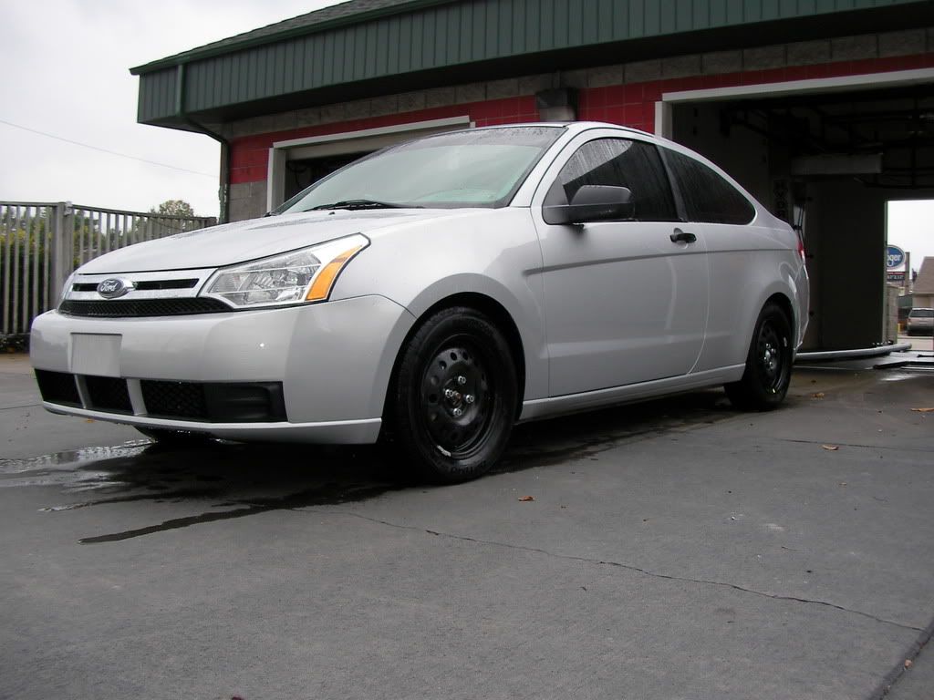

Hey everyone. I installed my frpp suspension today[wrenchin] , turned out pretty good. Drives nice and strait and handles MUCH better; i'll get an alignment in a few weeks after it settles in. I measured it before and after and it was only like a half inch difference [dunno] so I really hope it drops more.
carwash[bath]
threw in the gf's fusion:
NO HUBBIES! ftw!
Man I need rims[burnout]
8,023 Posts

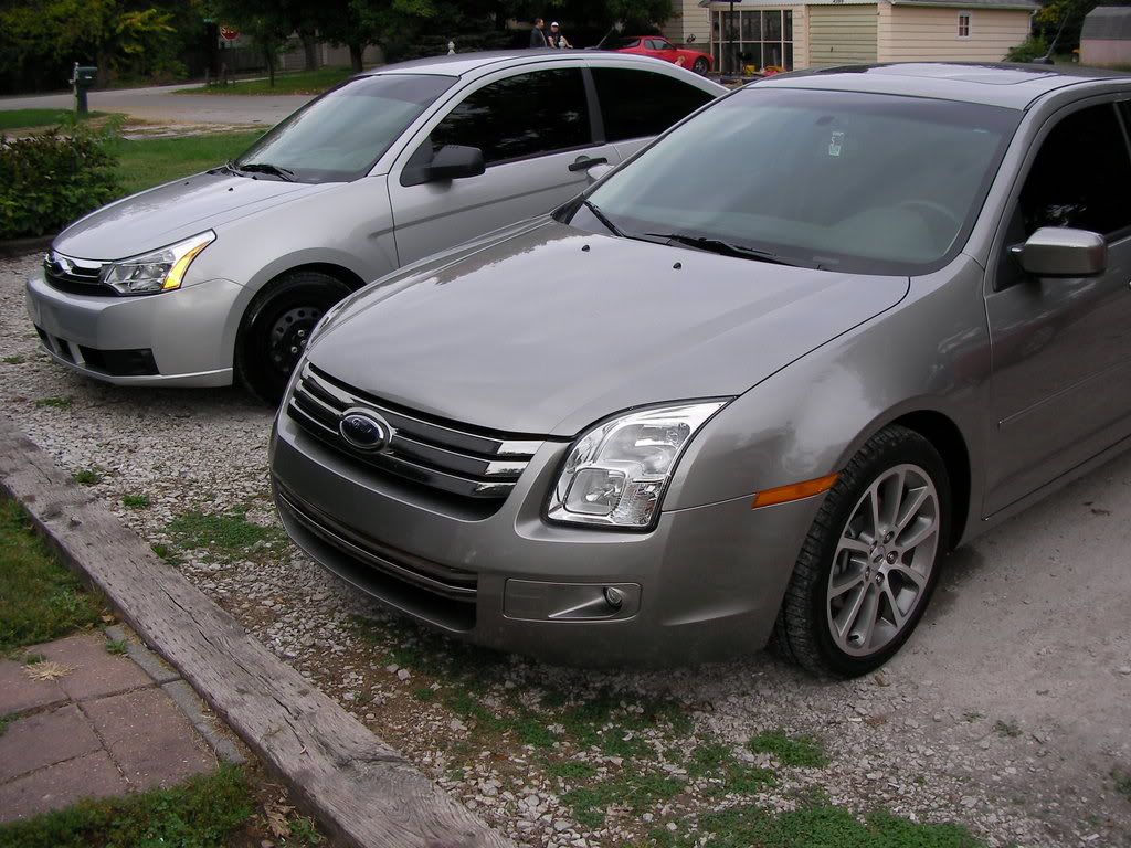

damn looks real good. It's crazy how much the lack of the side "vents" help the flow of the car. love the second picture of it dropped.
I'm partial cause I have that kit on my silver 07, and i'm rockin the steelies as well
