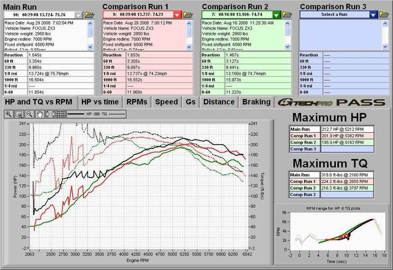

G-tech Dyno of the Ford Racing Intake Manifold
I just recently added a new mod and here is a before and after g-tech dyno run. Take a guess what it is [:)] The green line is before the mod and the black and red lines are 2 back to back runs with the new modification.

Well the fact that you are already hitting 200 hp means you are boosted somehow and also cuz you posted this in the FI forum.....umm my guess would be more boost? Cams? Lightweight crank pulley? [dunno]

Yes, I'm boosting at 15psi but the boost didn't change. BTW, the g-tech numbers are about 50-70whp less than an actual dyno..........at least on my setup.

200hp and a 0-60 in 11.969? whatttt?

Don't worry about that 0-60mph, that's just because I was using the g-tech to calculate horsepower. Just like on a dyno, you gradually get up to gear and then hammer it at around 2,000rpm to get a wide range of the power band. So of course your 0-60mph times would be crap doing it this way. Also, the g-tech automatically starts to calculate horsepower when you shift into 2nd gear. However, my 2nd gear spins the tires as my rpms climb so I have to shift from 1st gear straight into 3rd in order to get a clean run. 2nd gear produces a higher whp reading than 3rd gear on the g-tech and my old 2nd gear g-tech dyno run with my supercharger was about 50whp less than when I had it on the mobile dynojet. So really you can add about 50-70whp on the g-tech numbers to get an approximate real dyno number.

wow thats good for a TB
