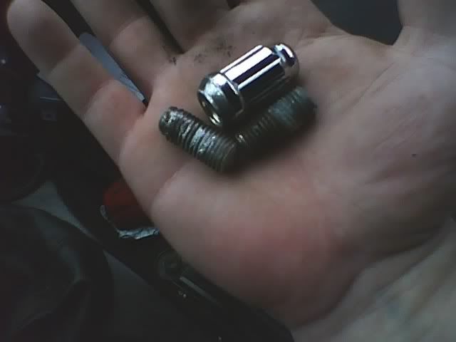

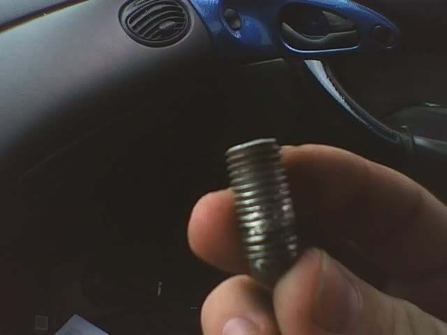

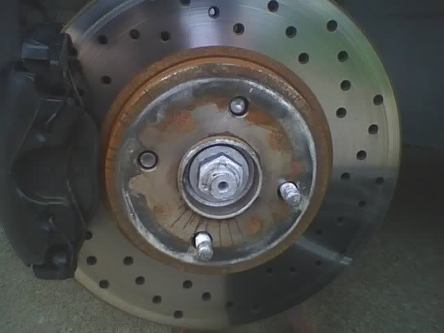

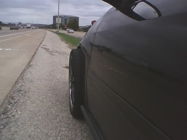

well my car has been down for about a week now and i couldn't find out WTF was wrong with it. at first i thought it was an axle but after getting my car jacked up i started to think that was not the case so i figured today i would take it to my girls work and let her boss look at it since he use to work for SVT. so i was on my way up their and on I75 at about 75MPH+ i started to get a bad wheel shake so i looked out the car to see a lug nut flying off my left front rim so i pulled off as fast as i could came to a halt so fast i sheared two bolts off the hub so i have spent the day and the better half of $200 to fix it..... here are the pix i took......
so with a new hub on the car oh and after replacing a shattered axle barring the fofo runs great... oh and to make this day better on one of my runs to the ford house so guy didn't yeld to me as i came off the high way and hit my girls car so now we are going to have to replace the bumper headlight and fender. fun day im going to go get [:)][:)][:)][:)][:)][:)]g drunk now. [goofydrunk]

Did you really have to replace the hub? The studs are not hard to replace because I did this without replacing the hub. A stud can only go in and out in a certain quadrant, either top left or top right, but I can't remember. If you look behind the hub, you will know what I am talking about. The thing is you would have to compress it in because tolerances are tight. Anyway, we are glad you are ok and the fofo is now ok.

You didn't even have to take the big nut out. All you have to do is take the rotor out, look behind the hub and you will see a slot where it would let the stud to come out and in, once you find the slot hammer the stud out and press a new one in and you're done. Remember to torque down the big nut you took off. I am not sure of the specs but if you don't, then the bearings might go bad really fast. Let me know if this helps.
