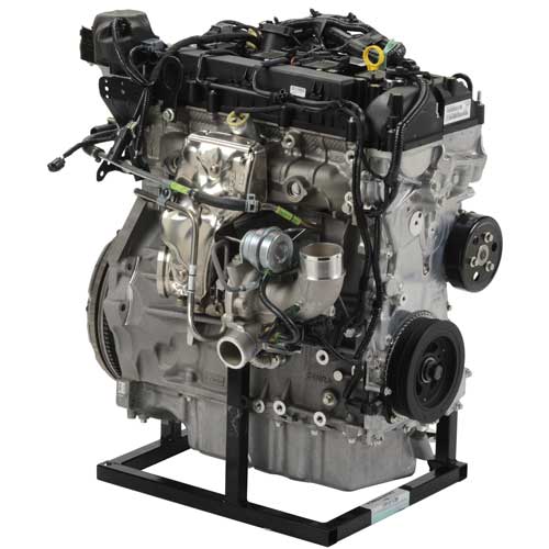

This (Part # M-6007-20T) +

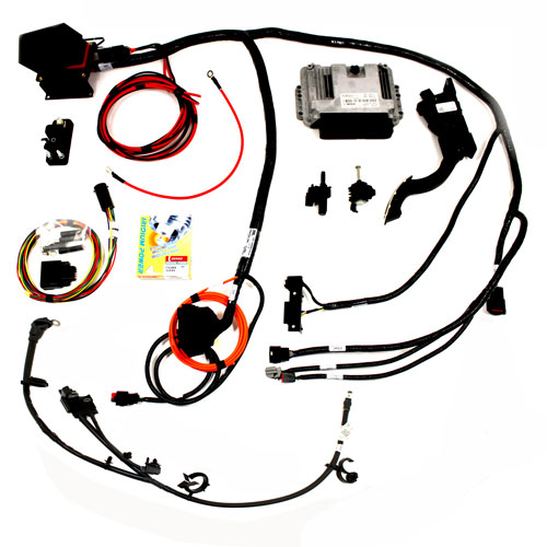

Control harness for the ecoboost crate engine (for custom vehicles Part #M-6017-20T)
Unique controls pack harness replaces stock body harness and is designed for custom built vehicle. Harness includes OBD-II diagnostic port to assist in vehicle calibration upload and problem diagnosis.
Includes PCM with Ford Racing performance calibration
Includes Electronic Throttle Control accelerator pedal, eliminating throttle cable routing problems
Includes power distribution module and oxygen sensor
Includes M-12405-20T Cold Spark Plug Set required for performance calibration
2.0L Ecoboost crate engine includes intercooler, air intake ducting and air cleaner assembly required to complete controls kit installation.
Come with custom Ford Racing tune
When used with Engine Control Pack M-6017-20T and 93 octane unleaded fuel, torque is increased 90 lb. ft at 2800 RPM - with a significant increase up to 4200 RPM
Price is 5500$ (lowest price I could find) for the engine + 1500$ for the ECU kit (eBay)

The difference is the Control harness is garanteed to make the ST engine work in a focus! (with some modification)
Bonus the MTX-75 is bolt-on!
EDIT: Also donor ST engine would work with the custom ford racing harness!
EDIT2: Sorry to burst your bubble guys but this is the closer we could get for now!

Question how difficult would that swap be. I mean would it just be a drop in and go? Will it mate up nicely to the NA mounts? Like
Focus Preacher
3,417 Posts
In theory yes, same mount points...
However, I can't be exactly sure 100% since no engine drawing/specs are available for now.

I mean I know that a lot over the mounts are the same. But would you have to upgrade axles and brakes?
Yes but that would be the same for a reg. turbo kit!
MTX-75 can handle safely up to 206 ft-lbs of torque and the ecoboost is 270 ft-lbs!
The weakest point is the diff. but fortunatly it is upgradable.
The advantage is the MTX-75 have many upgrade parts. (Take a look at all the SVT (first gen) Focus monsters on this forum)

And I take it the MTX-75 Is the stock NA harness.
The MTX-75 is the 5 spd manual transmission. It doesn't need a TCM hence no harness going to it (except neutral switch and speed sensor).
The only problem I could see is the blinking dash saying engine failure because it (focus harness) wouldn't be connected to the engine anymore. (Now two separate systems)
ESC, Torque Vectoring and TC wouldn't work anymore (need throttle input & kill the ignition or retard it)...but they are not critical.
