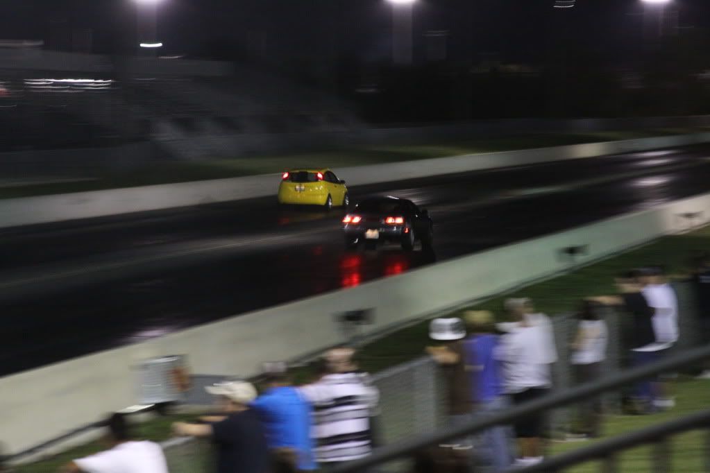

He went to OSW about two weeks ago now with his new tire setup. 23x8.5x15 M&H slicks with matching skinnies on the rear. His setup consist of a Header, intake, exhaust, cossie intake mani, tune (which isnt finished) and a wet 75 shot. His interior of the car is gutted but he has ac, heat, ETC. His first pass he clicked off a 12.631 with a badass 60ft. Cant wait to see what he does with a finished tune and running at bradenton track instead of Orlando speed (spin) world. should go 12.5 or 12.4 i think.
Heres the break down of the slip
And here some track pics
