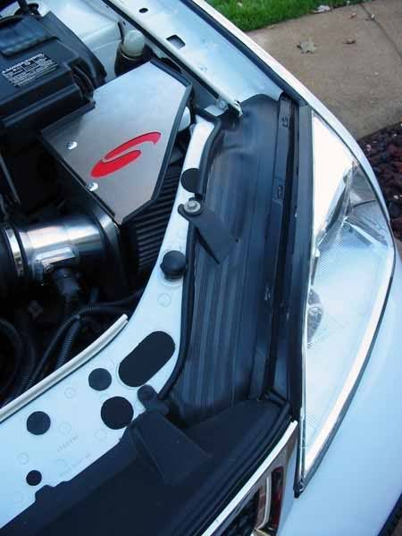

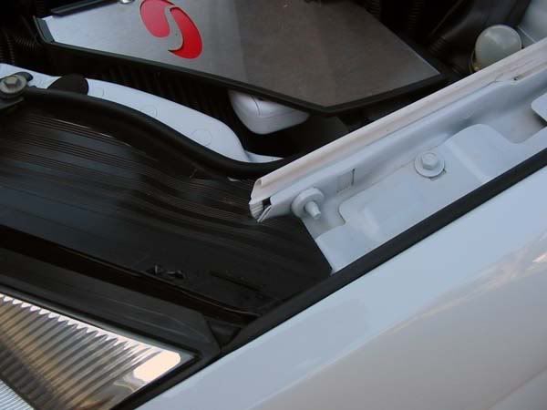

Now look at the OEM water channels, at the edges of the fender. These drain some water toward the headlight area. They can be improved. I raised the inner edge about 1/2" using a window seal. (everything I used came from Ace hardware). I also sealed the edge of the hood with an automotive "D" rubber seal. This keeps water on the driver side of the hood, from draining into this channel. I didn't seal the hood on the pass side.....hot air off the engine escapes from this opening. (most everything but this, is duplicated on each side). I also applied a caulk seal where the shock tower is welded to the frame....keeps down rust.
Any water that makes it into these drain channels, runs down toward the headlight.

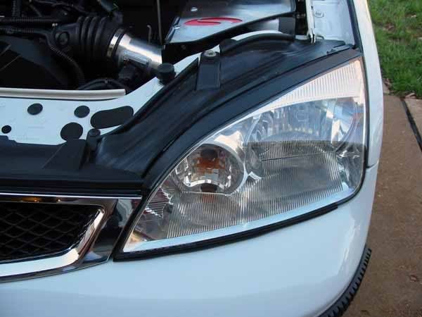

I made a rubber cover for the top of the headlights....water drains down toward the lower edge, where it empties toward the ground.

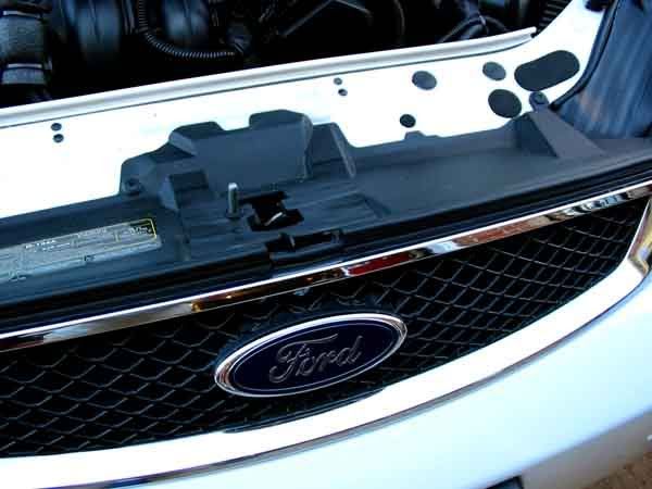

OK....that's about it for rain protection when the car is not moving. On to #2. While you're driving a surprising amount of water enters the eng. bay. The water that enters through the radiator cannot be avoided, just cleaned up. The other water can be mostly stopped. I took some long foam strips (used to seal around window AC units), and closed off the open spaces on both sides of the radiator (can't see this). So now if I spray a hose into the grill, the water only goes through the radiator fans, like it should. I also used more "D" rubber strips, and sealed above and below the headlights.
Above the grill was also sealed, as well as around the hood latch opening.

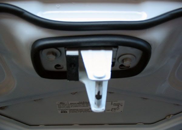

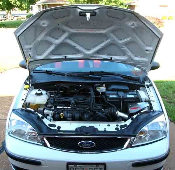

On the hood itself there are more seals, around latch piece, and completely around the hood itself. This last seal doesn't touch anything, but it catches some water that makes it past the other front hood seals. You can also see this seal on the over-all photo of the entire bay.
That's about it....my engine bay stays completely dry sitting in the rain, and washing the car. When driving in the rain, some moisture of course enters the bay, but probably 75% less than stock. The Steeda stays dry at all times....so far anyway.
