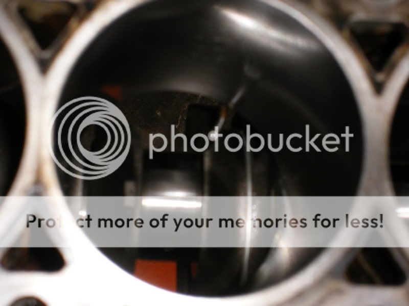

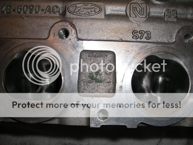

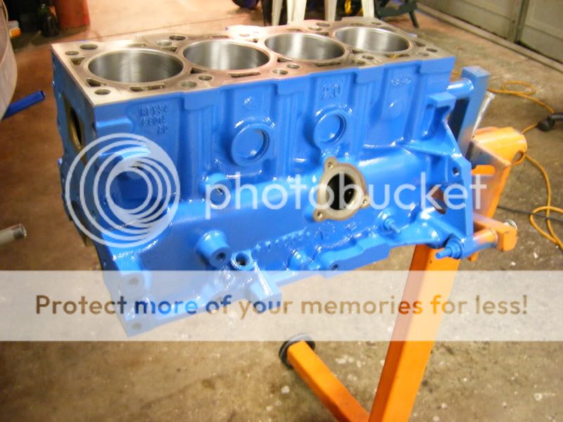

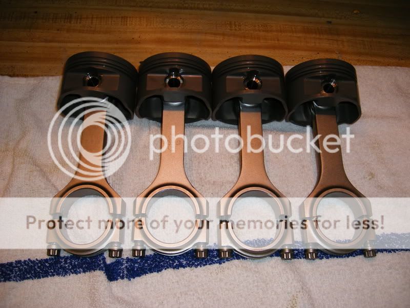

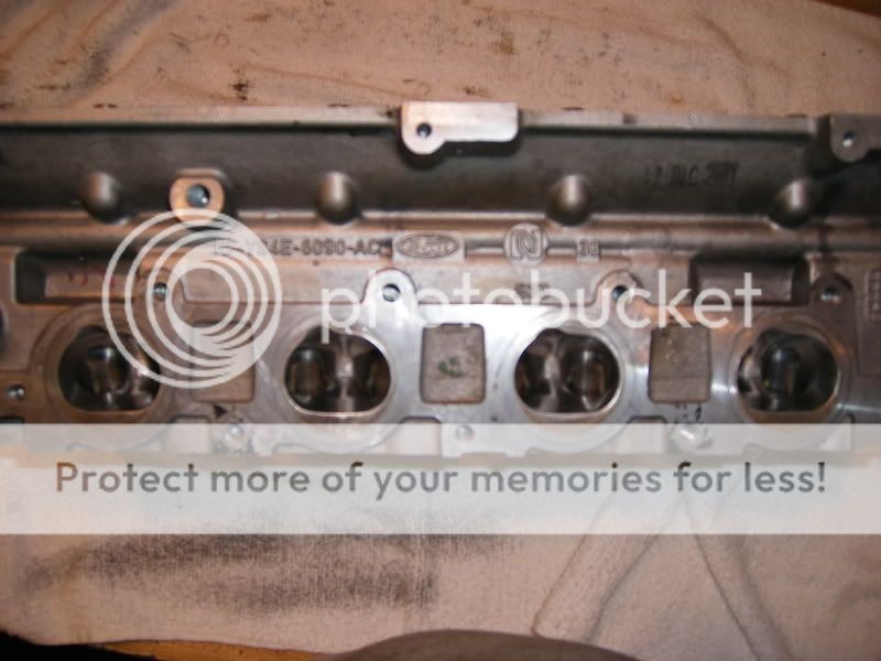

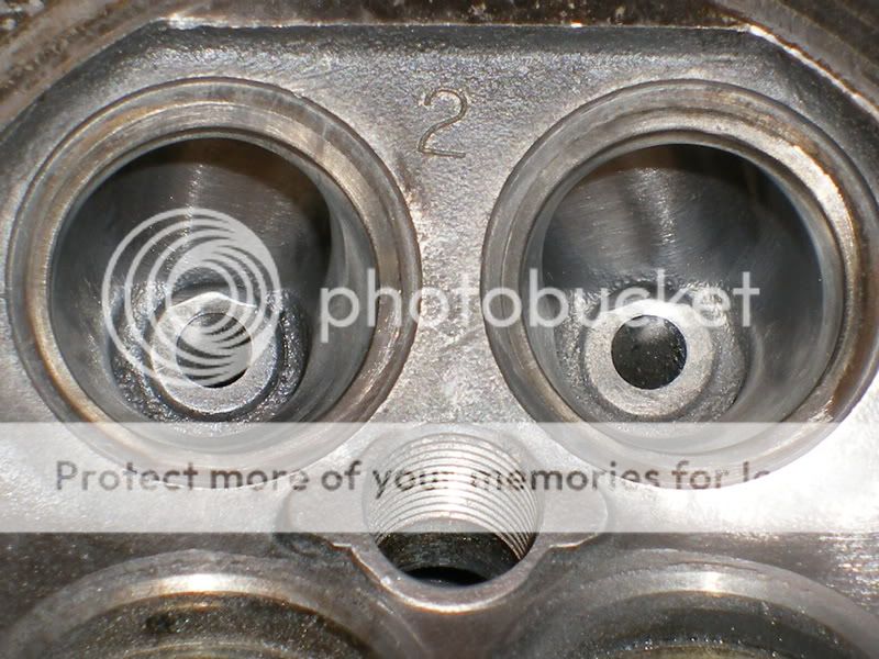

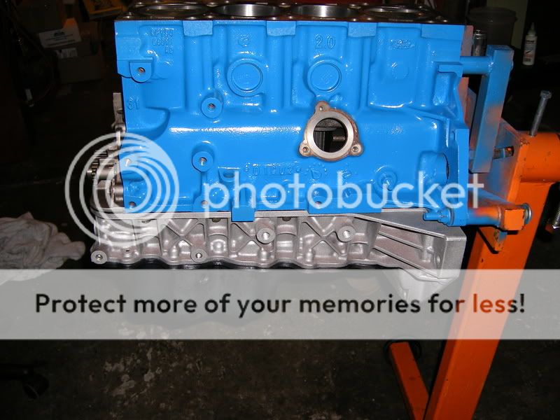

Hey guys well i found a SVT block for cheap so i decided to pick it up and build it. This block is built with Supertech Pistons, Eagle connecting rods, Clevite race bearings, Clutch masters stage 4 clutch, and a clutchmasters light weight aluminum flywheel. Now the Head Is ported and polished by me. i took my head too my local engine machine shop who boared and honed my block and they said the porting looked great. [grinking]
Also for some of you that dont know this is going on my turboed focus it has a custom tubular amnifold made by me and a turbonetics GT-K 450

Ya, u did a really good job on the porting!!!
4,739 Posts
hey thanks guys and we will see how everything works together after i get it broke in and Tom tunes it :)

o and i will take pictures of the intake side porting when i get the head back. i didnt have my camera before i took it too them

Its not too late to unshroud those valves and polish the chamber right?

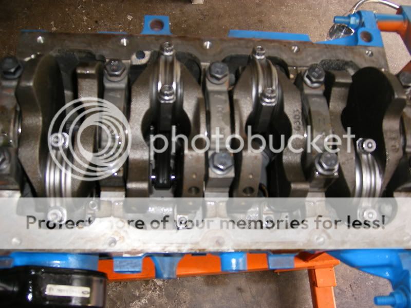

ya you didn't even use arp mains, I've seen stockers last til 300whp, and I've seen them break at 200whp . I'd get some arp's if I was you.

No please donT , It isnt a bolt it togather deal , My bet is there isnt 2 people on this forum that have the proper tools to build an engine
Dial bore Gauge
The ability and tools to set the proper bearing clearances , Piston clearances , Ring Gap , Adjust deck clearances and rod length for proper end compression
A way to polish and check crank sizes , bore sizes , big and small end on the rods and mains housings and I could go on and on
Most dont even reline bore there block after installing main studs or hone the blocks with deckplates or check for block distortion when using head studs , Most dont cut the deck to squair the block from one end to the other we have seen them off by as much as .010
No please dont do a how to on building any engine

Hey Tom i will not do a engine right up because you are right about all of that and luckily my block was not distorted at all my machine shop checked it also i do have arp head studs i jus havent installed them and about the billet main yes ik i should of got them but i ran a little short on money. but i will have more pics when my head gets back woohoo :)

well i had a sleeve put in too but all together with all the machining done and the pistons custom fitted it was 200.00
