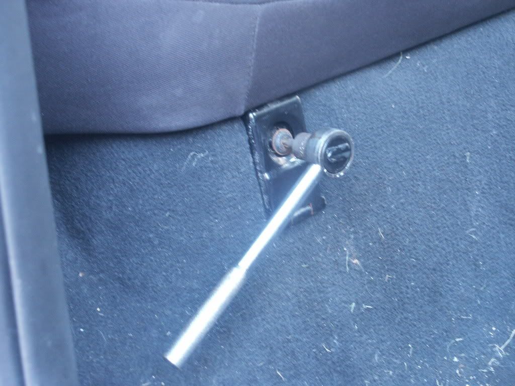

On Oct 30th and 31st, I launched into this project in an attempt to subdue a bit of the road noise coming from the back hatch area. Here're some before and after pics.
Oh, and before I forget, if you do this project, for cryin' out loud GET THE ROLLER! I sliced and diced my finger tips on the foil backing ... my fingers hurt for days afterward!
First, remove the rear seat and backs using T-40 and T-45 bits and pick up loose change and old french fries:
