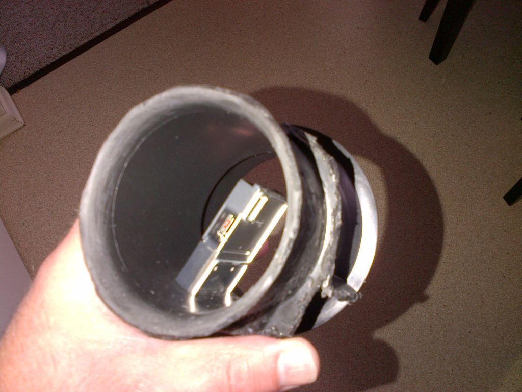

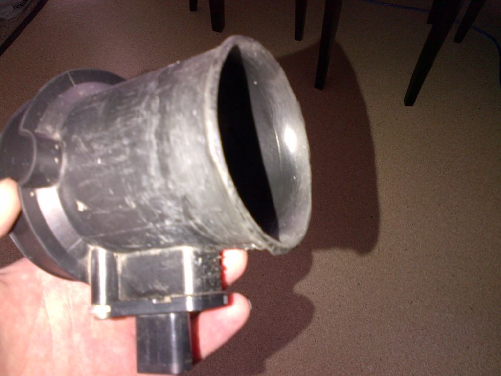

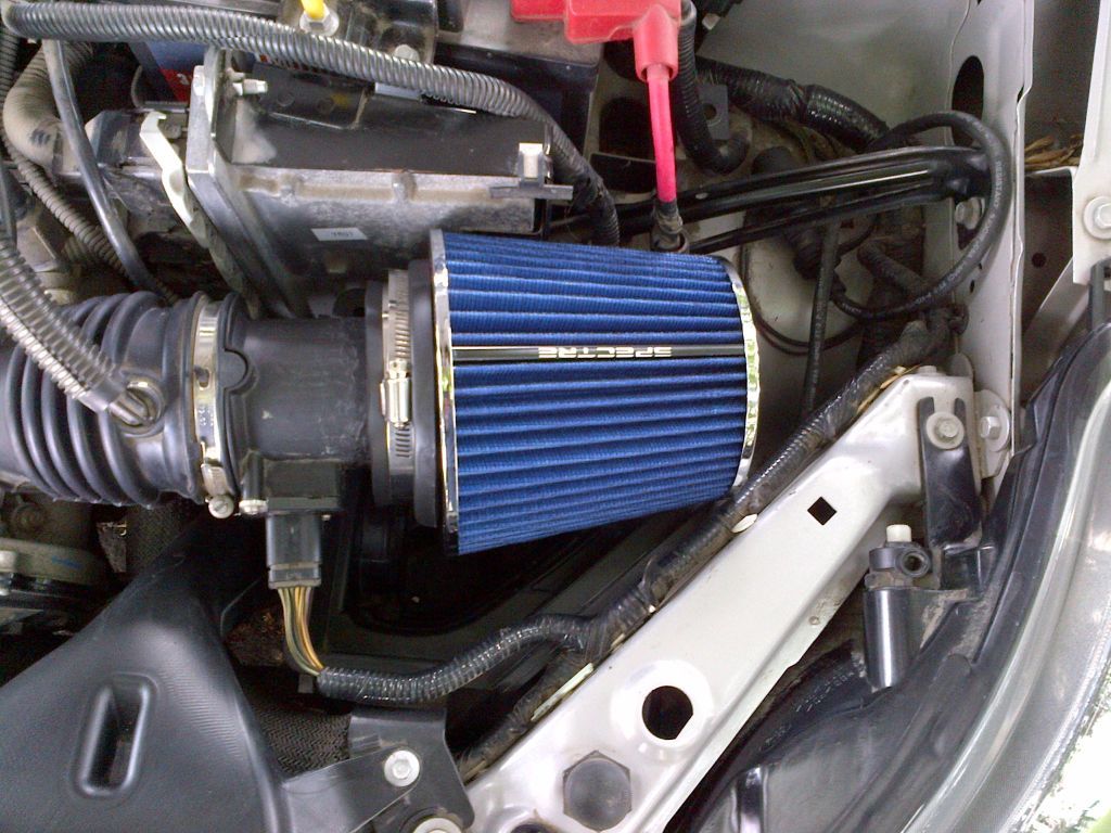

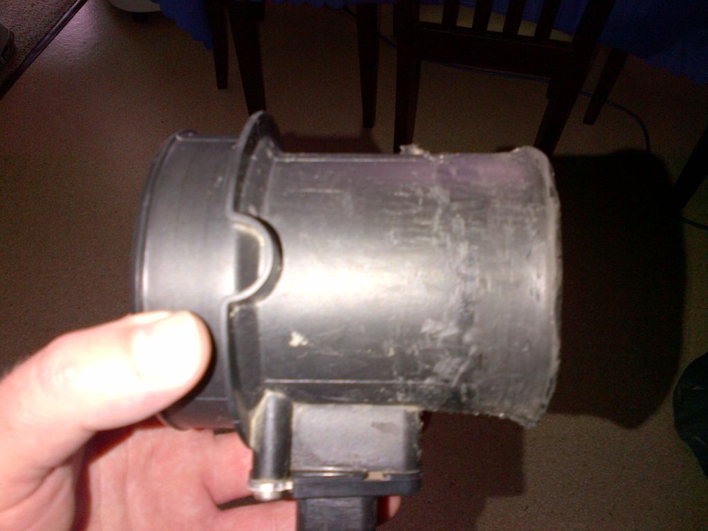

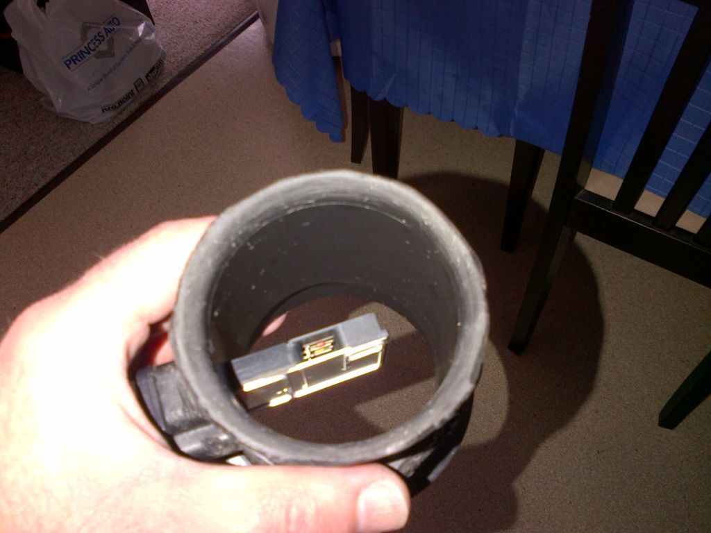

I've been running this for over 2 years without issue. No CELs, no issues whatsoever. I know it's not the prettiest thing, and I don't care, it works and that's all that matters to me. Anyone wanting to do this, all I can say is Take your time. The edges are rough because I didn't have my dremel, but I made do. I think mine's worked so well because I left a small amount of the flange at the end, I did so in hopes the air would hit the MAF with the least amount of turbulence. I left the bottom of the air box installed, and the snorkel, the filter sits quite nicely on it, plus the added air from the snorkel, and the piece of mind that water Will Not hit it. [:)]
The pics aren't the best, my apologies, but they'll make do for now.
I'm sure I'll get flack from some as it's not pretty, but, it works, and has so for a couple years.

I'd like to clean up the edges and finish, but it works so well I don't want to touch it. Once the filter is on you can't see the rougher edges anyway.

Since reading this I've read up some on filters and it seems uncertain on wether the K&N (and spectre) filters are actually worse than standard dry filters. I bought a red Spectre conical filter to use in this diy mod and now I'm scared to use it.
I ran a motorcraft filter 80,000 miles (maybe 111,000 if it was the original one when I bought my car at 30,000 miles) and recently installed an STP filter from autozone as I was awaiting these pictures. Reading the reviews and opinions here I'm now affraid the STP filter might not be any good either.
