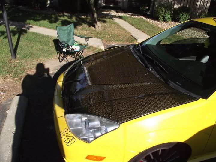

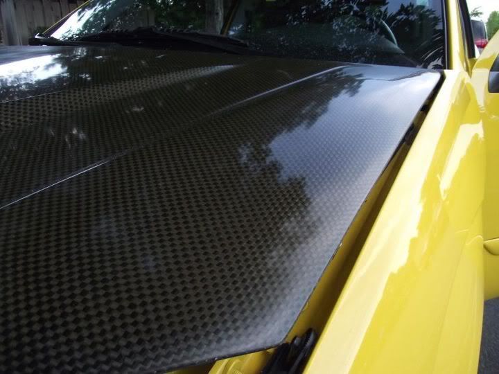

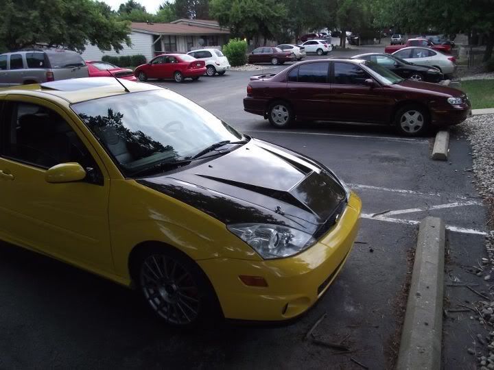

well as some of you guys/gals saw my car at FF this year the hood had been wet sanded down do to oxidization on it I finally got around to finishing up the work on it.
I ended up garbing a bottle of presta super cut compound that removes up to 600 grit scratches and finer only $20 for the bottle
I ended up using a 6" orbital which I don't recommend cause it takes for ever with one that small
the hood has about 14 hours in it right now, I also have about another 4 hours into the headlights using the presta compound on them as well.

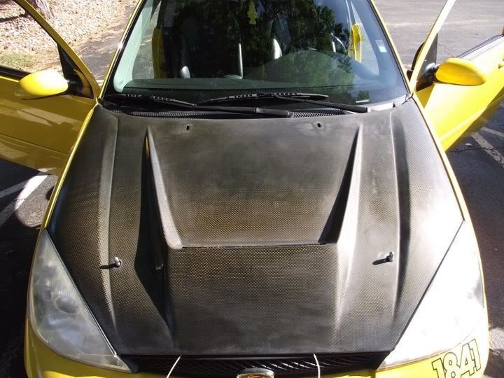

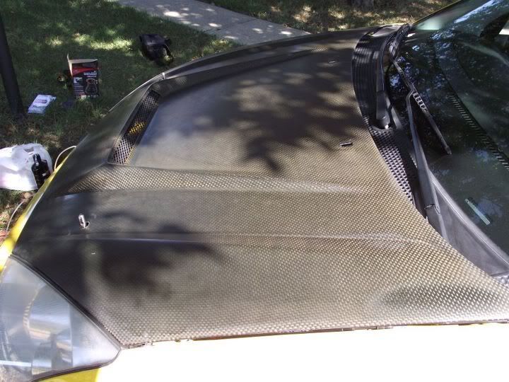

this is what it started out at wet sanded with 600 grit
after a few hours

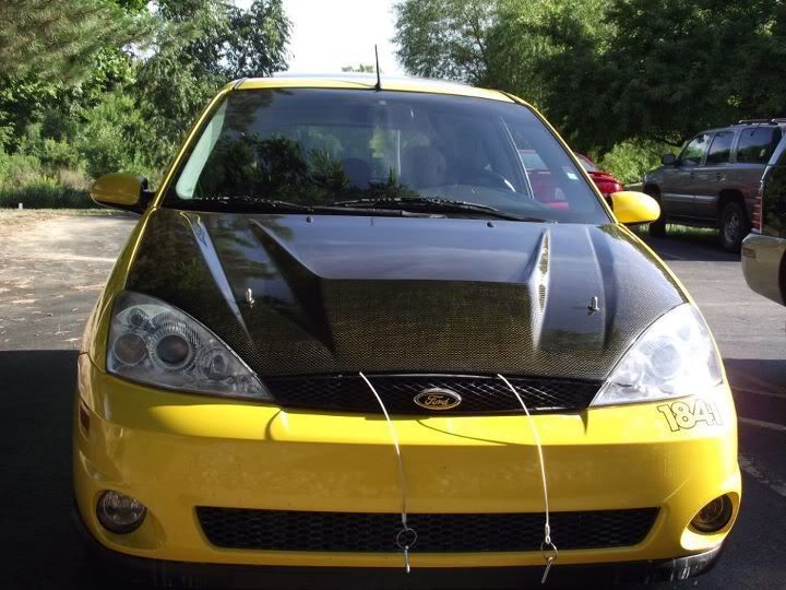

then the finished product
