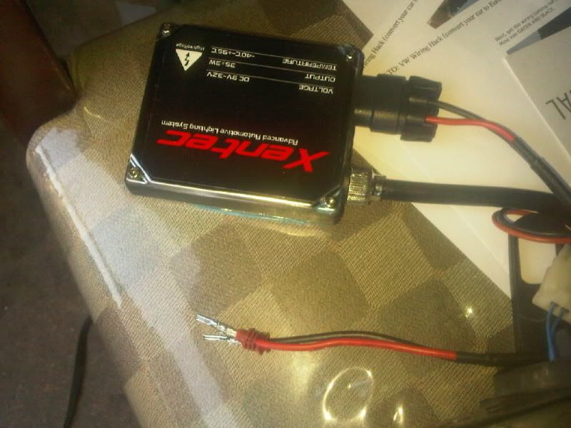

Hi Everyone,
I just recently bought a pair of depo mach hid headlights. I knew they were not going to come with bulbs and the ballast.I ordered some d2s hid kit for it but I amd having trouble on where to plug the ballast power. As you can see in the picture the wire have 2 connectors.I just dont know where to put them. ANy help would greatly be appreciated.[dunno]

Oh boy, are you gonna have fun.
You pretty much have to hack the internal wiring harness of the headlight. Search for the How To Install Mach Audio Headlights doc, and figure out which pin is low beam. The positive wire from the ballast goes to that. There should be 2 grounds, I forget which, but one of the grounds is for the ballast. I didn't put that at first and my HID's didn't work.

It's pin 2 but the weird part that there are alot of black wires and 3 red wires where the ground should be. I dont know if i should just get a tester and see which one is power and which is ground.
