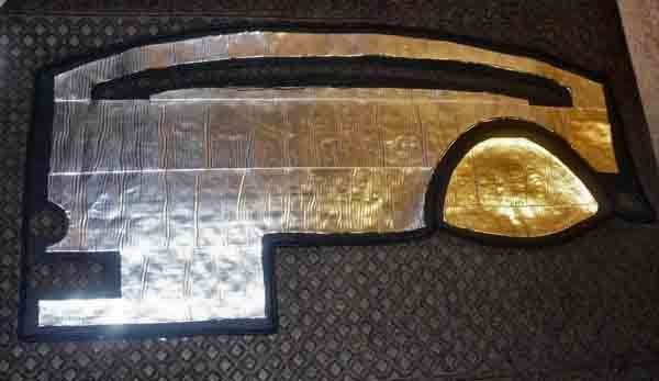

Got a Dash-mat the other day.....$33. And I did a few mods to it before I installed it today. There are several variations of these things, but the only one I found for my '06 was the base carpeted model. It was virtually a perfect fit.....I only need to enlarge the pass side vent hole slightly. But before I installed it, I did a few mods to make it more functional
This is a very light-weight carpet. And I would like for it to mute some engine noises. Here's what I did....a picture of the back-side covered with "roofer's tape" from Home Depot....

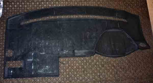

Then to stiffen the thing, and cover the roofer's tape in case the adhesive might touch the dash, I covered the tape with sticky-back felt pieces from a craft store......
Now this mat is about 4x as heavy as stock, and is sort of like the custom molded dash mat that was unavailable for the Focus. When you place the mat on the dash, you press down on it and the Roofer's tape conforms to the exact shape of the dash, and holds it's new shape. Plus....it will now just sit on the dash without any velcro. Does it quiet down the engine....yeah, somewhat. This latest mod is part of my on-going noise reduction project. When I'm finished, I should own the quietest Focus ever.....one that's still running anyway. [;)]
