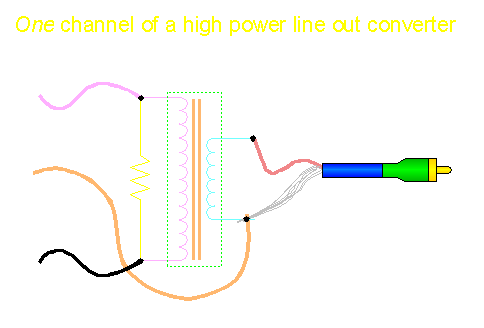

Construction:
A high powered LOC consists, primarily, of a transformer and a high power (10 to 20 watts) resistor. The resistor is used to load the amplifier in the HU. Some amplifiers will exhibit less than ideal manners when they are unloaded. Remember that we said that the HU's outputs had a large quick increase in DC voltage when the HU is switched on. The transformer will pass the difference in voltage between the two input terminals. Since the DC voltage increases simultaneously on both of the input terminals, the pulse of DC is canceled out. If the LOC simply used resistors as a voltage divider (with no transformer), the turn on pop would be severe.
Note. The transformer also gives you a clean ground which wasn't available from the bridged outputs of the head unit.

Picture of circuit diagram
