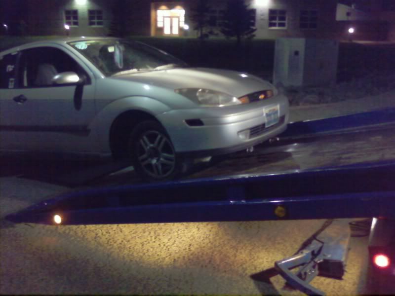

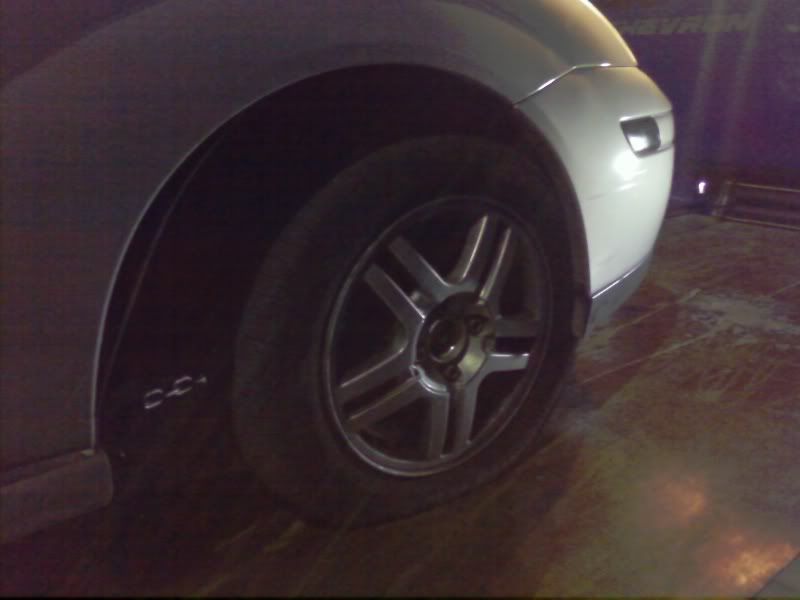

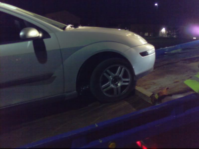

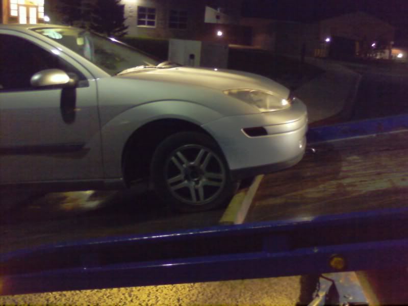

Havnt posted here in awhile because the focus has been running awesome. Till tonight, took a weak speed bump at like 15 and yeah....
[nutkick]
the driver said it was the upper ball joint, if hes right how much should i be lookn at for repairs, im gonna need alignment and a new tire also.

Well, that definitely doesn't look like a speed bump damage and even less at 15 mph. I have beaten my car very badly and never had such damage. As far as repairs... well I don't know.[werd]

are u sure te speedbump wasn't an 8 inch curb?? lol sucks bad man, GL

so....you hit a speedbump and the wheel went FORWARDS? or that happened AFTER you nailed a speedbump and kept driving around? you seem like you could care less.
Car Abuse........poor thing....[:(]
umm no. i hit a road hump, the wheel went right into my front bumper and i skidded to a stop pretty much. i wouldnt try to drive it.
And the tow truck driver ripped my axle out this morning [headbang]

7,936 Posts
We dont have upper ball joints....
To me, it looks like you will need:
lower control arm/balljoint assembly
inner tie rod
possibly steering rack
strut
possibly spring
possibly need to reshape your strut tower or your suspension geometry will be wrong
might possibly need a new knuckle if it is cracked
probly a few things i missed.
