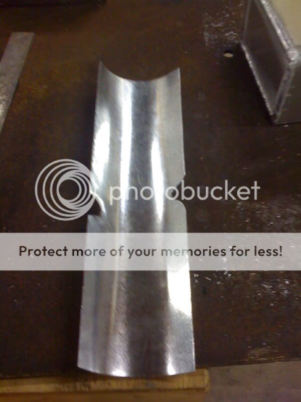

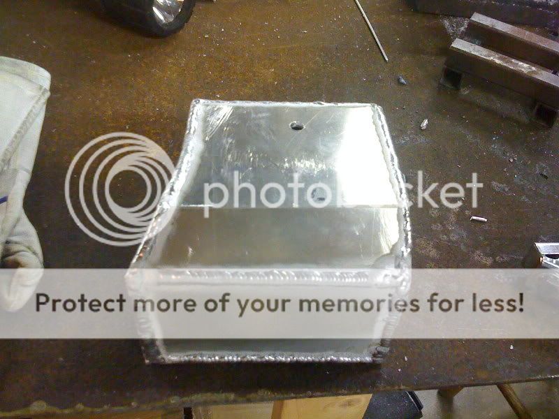

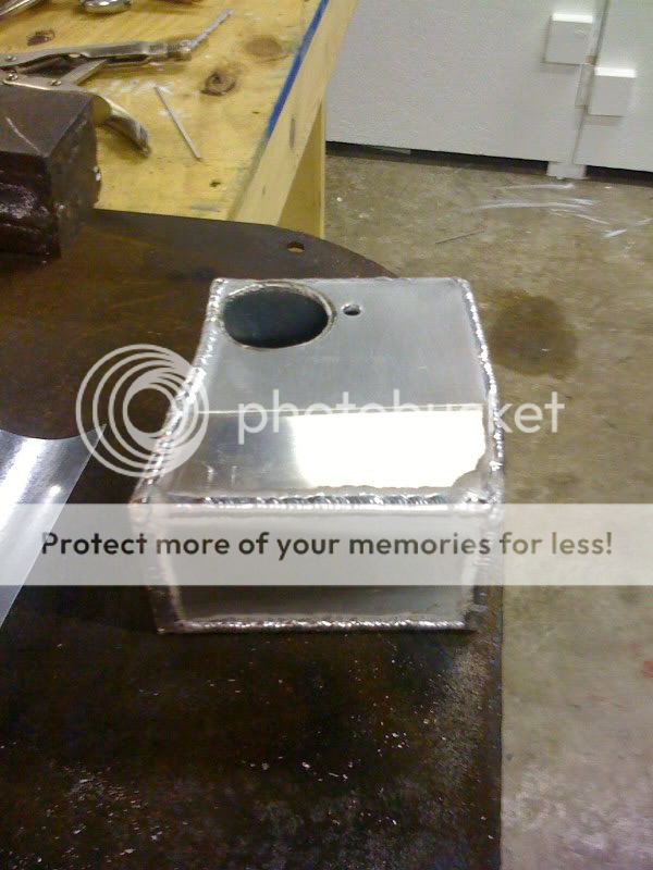

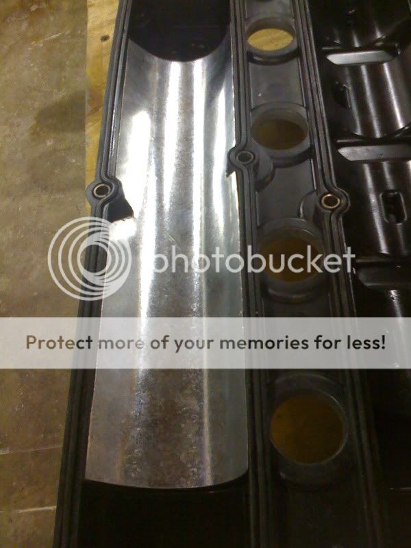

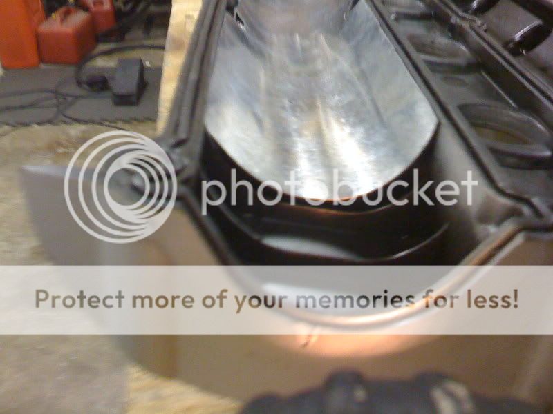

Hey guys so i got kinda bored but also have been wanting to do this to my foci. So i built a catch can with internal baffling in side. This setup will run two -10an 90s off the front of the valve cover and soon enough it will run a -10an line all the way from the pcv plate to the catchcan. its not all finished yet i still have to buy all the line and weld in the filter opening on the top (already done now pics were takin yesterday). Now the valve cover im making my own baffle and it tucks up under the lip on the inside of the vlavle cover and it will also get epoxied in.
