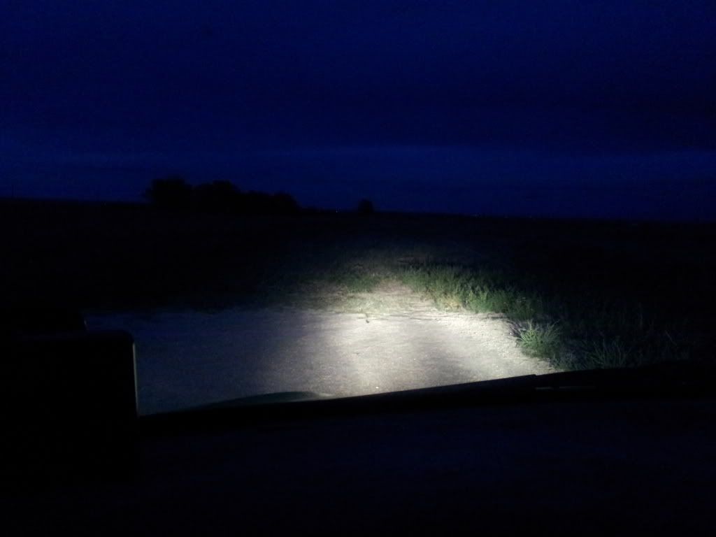

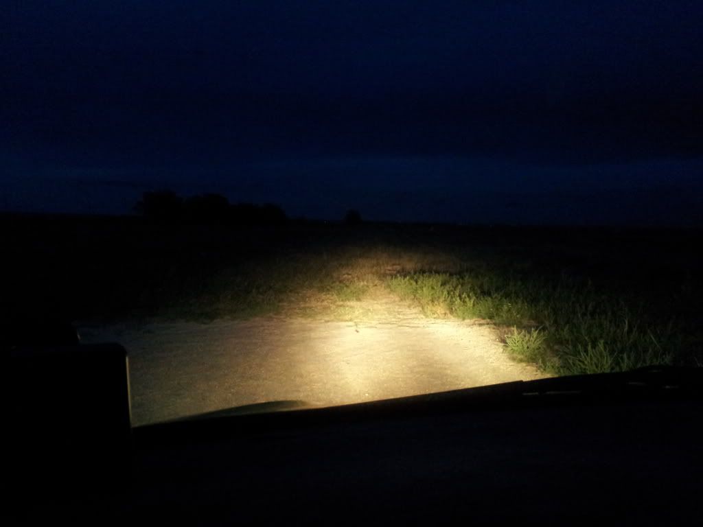

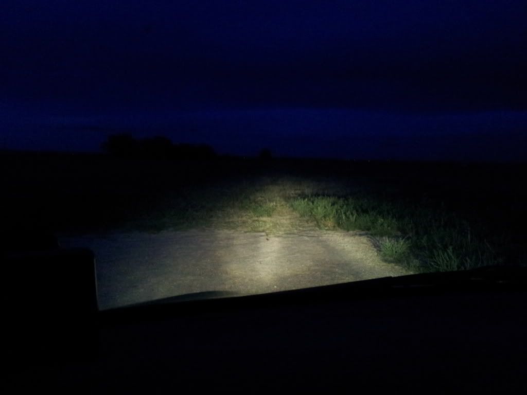

finally got the pics uploaded. the stock projectors aren't much different lighting wise from my stock headlights because they are so clouded up so I don't notice much of a difference but I do understand upgrading to a good set of projectors will dramatically improve the output. especially with a set of D2S 5000K set up I'd like to have. but as you can see from the pics, the lighting sucks all around. the low beams shine the furthest and they go maybe 90 feet in front of the car.
