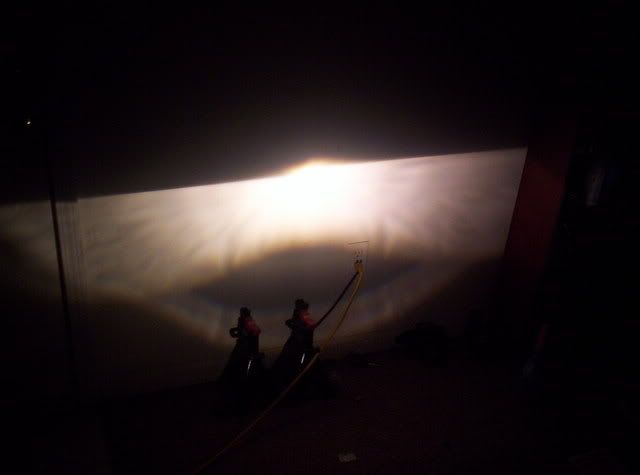

Many of you guys like to ask, well so what if it is a halogen projector or or so what if it's HID spec projector. Well here are two pictures i took myself of why this sort of thing can and in fact does matter when installing these systems in our headlights.
Below are two pictures taken in my own living room.
Below is a Hella Spec projector......but in what??
And the cut off pictured here is from a TSX spec valeo projector.
^^^ So why would such nice projectors put off such HORRID cut off??
the answer is easy guys these were made to be used properly and correctly with the aid of a HID kit stock or aftermarket. The way projectors and shields as well as how a bulb is made will determine the way our light is shown.
A stock OEM style halogen or even a Xenon has what? A colored tip if you look. This sits behind the shield and the light is thrown from the areas behind that tip reflected. When it is put into a housing with no "mirrors" if you will. It is thrown like above.
Now a HID bulb has a more slender typically a bit longer full bulb. Without going into detail this is the difference when a projector is correctly fitted with the right style light source.

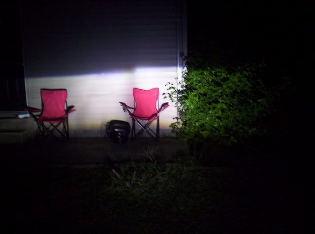

(not perfect) But this is our TSX spec valeo with a 6000k HID Xentech kit tested from my own car.
Notice how its a full and adequate throw with all areas lit and a single cut off then light below? This is how to tell specifically is a projector is designed for such usage. Because when installed you obviosuly see a huge difference.
