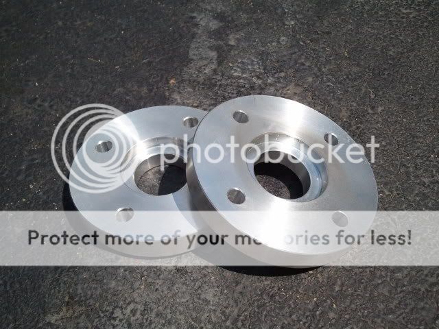

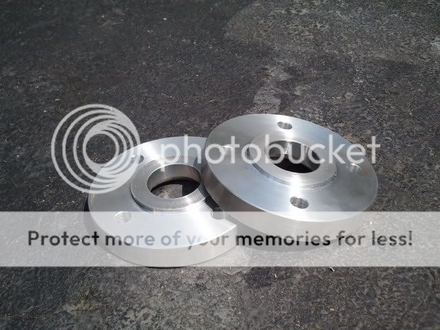

Well I was hating the idea on have to buy another set of wheels for autocross, already own 6 sets of wheels. So I turned and milled me some spacers so my current autocross setup would work on my new car with the SVT brake conversion. There is about a gap to fit 2 credit cards between the wheel and caliper. Here is 2 pictures of what I made up. Yes I forgot to take a picture of the wheels on the car at my autocross event yesterday.

I run a 15x6.5 with 42 offset. Hopefully get wider 15s for next season.
Might be able to get a couple pictures up tonight with the 15s on.
I have already thought about making more and selling them just trying to figure out a price. They way I made these is that the spacer centers on the hub and then the wheel centers on the spacer. I am also running longer studs but I might buy some to sell with the spacers if I do end up making sets for sale. Stock studs will not work at all.
