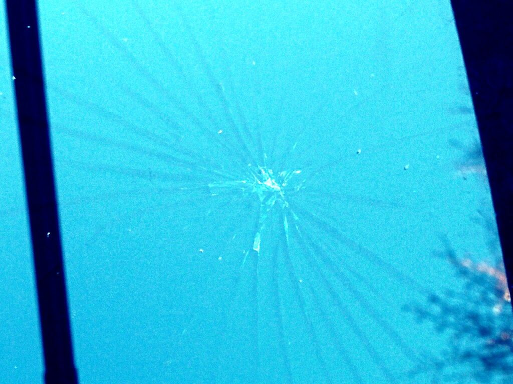

So the other morning i was cleaning '12 SEL, i just finished the windshield and then i was going to clean the wiper blades. I cleaned the driver side blade and moved to the passenger side, as soon as i picked up the arm the wiper blade pops off which caused me to release the wiper arm and it slammed into the windshield leaving this nice mark:
So after 5 minutes of kicking myself in the butt for not laying the towel i had sitting on the hood onto the windshield i called my insurance co. and was able to get it replaced for free. My insurance co. used safelite autoglass to do the repair and i opted for the service to be done at my house.

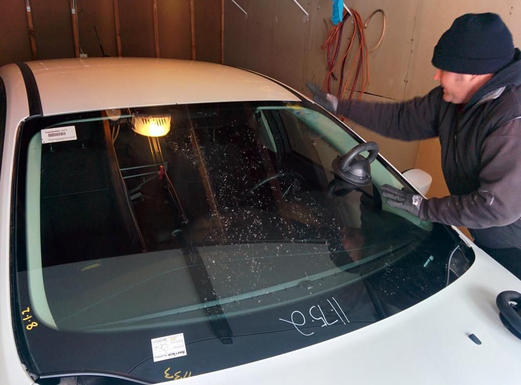

The technician showed up on time and was cool with me taking pics and helping with the project. Now to the how to portion step by step as the technician did it:

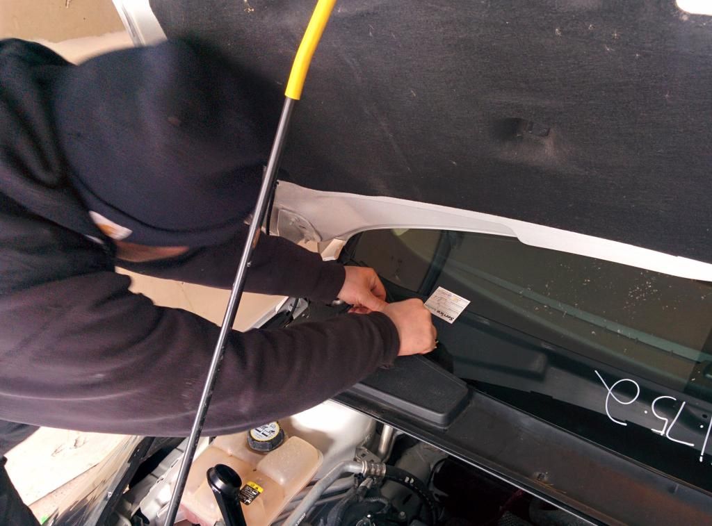

First: pop that hood and remove the upper cowl panel ( 2 screws and 4 pushpins)
2ND: Remove the thick rubber seal that sits between the cowl and hood

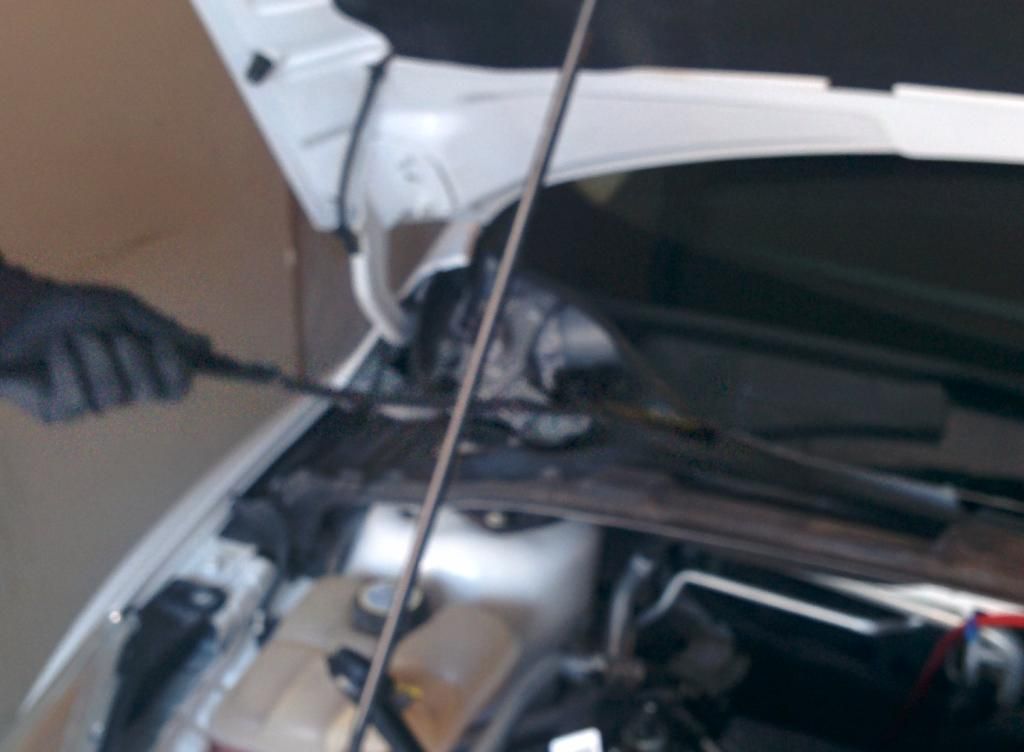

3RD: Remove the windshield wiper arms, first remove the rubber bolt cover and then remove the nuts with a 15mm socket, you will need to rock them back and forth to get the wiper arms off the wiper motors. Be sure not to lose the washers when you take the nuts off.

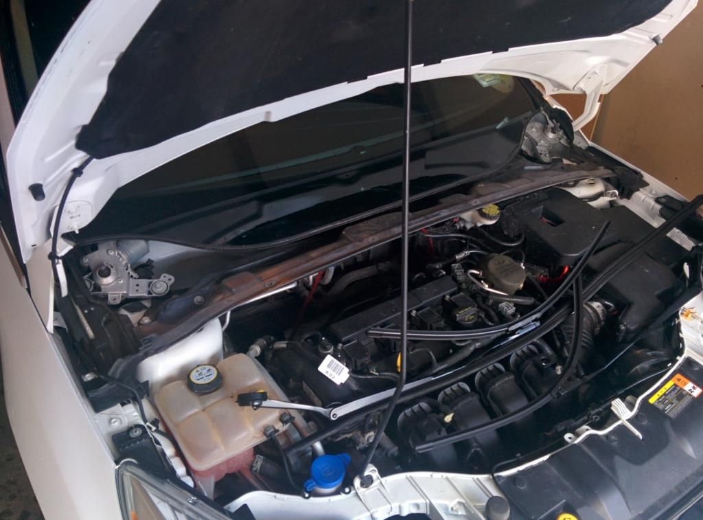

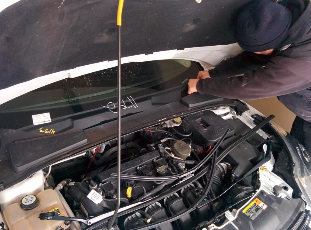

4TH: once both windshield wiper arms are off (and you put the bolts and washers in a safe spot) remove the windshield trim. Using an interior clip removal tool, wiggle underneath the locking tabs until they pop off

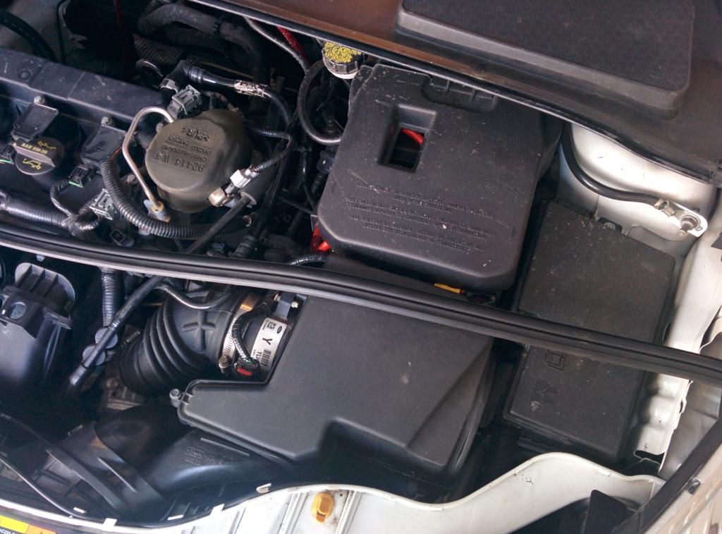

5TH; after the trim is removed you can now remove the upper cowl you were working on in previous steps, it will just lift off. ( the angle of the first picture gets a good shot of the factory strut tower brace)

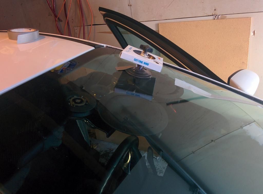

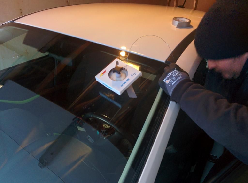

8TH: he then got his windshield wire in place and ready to cut the old seal.
NOTE: be sure the wire goes in between the cowl and lower part of the window as shown by the arrow. he warned that if the ire was not placed as so it could cut the welds between the cowl and firewall.
9TH: Next the tensioning device was suctioned to the inside of the window and the windshield was was then looped in it using a socket wrench he then cranked on it which caused the wire to cut the seal.

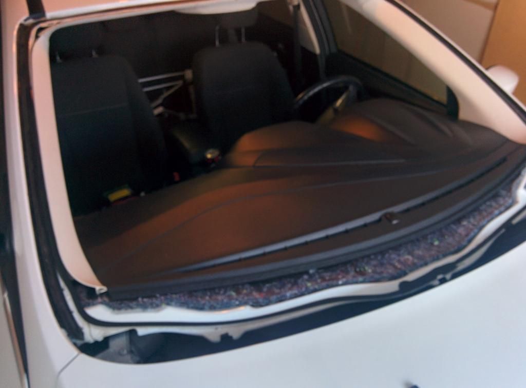

I didnt get anyshots of the windshield being taken off as i helped with that. Here are a few shots with the windshield out.

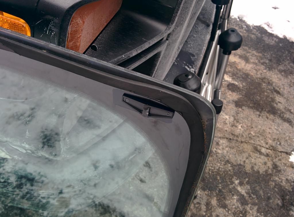

This is a picture of the factory windshield removed showing a locating tab (there is on on each side of the inner glass) that is used by ford at the factory to ensure proper alignment. The replacement windshield did not have these tabs.

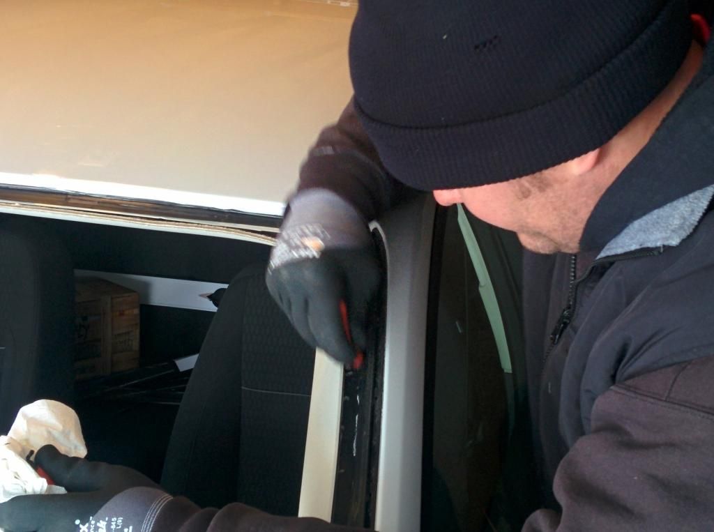

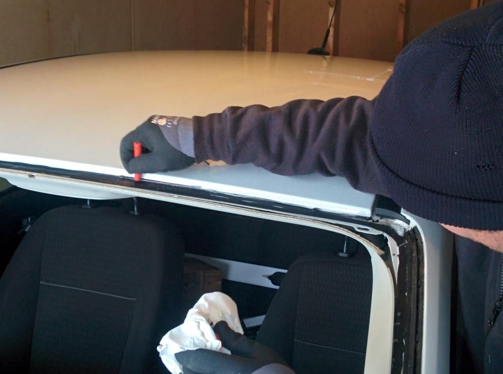

10TH: scraping out the old sealant, he got out most of it but said to always leave a little of the old seal in place because the type of adhesive used from the factory adheres better to paint.
The next pics show a rubber type prep product used to fill any areas in the left over sealant showing paint

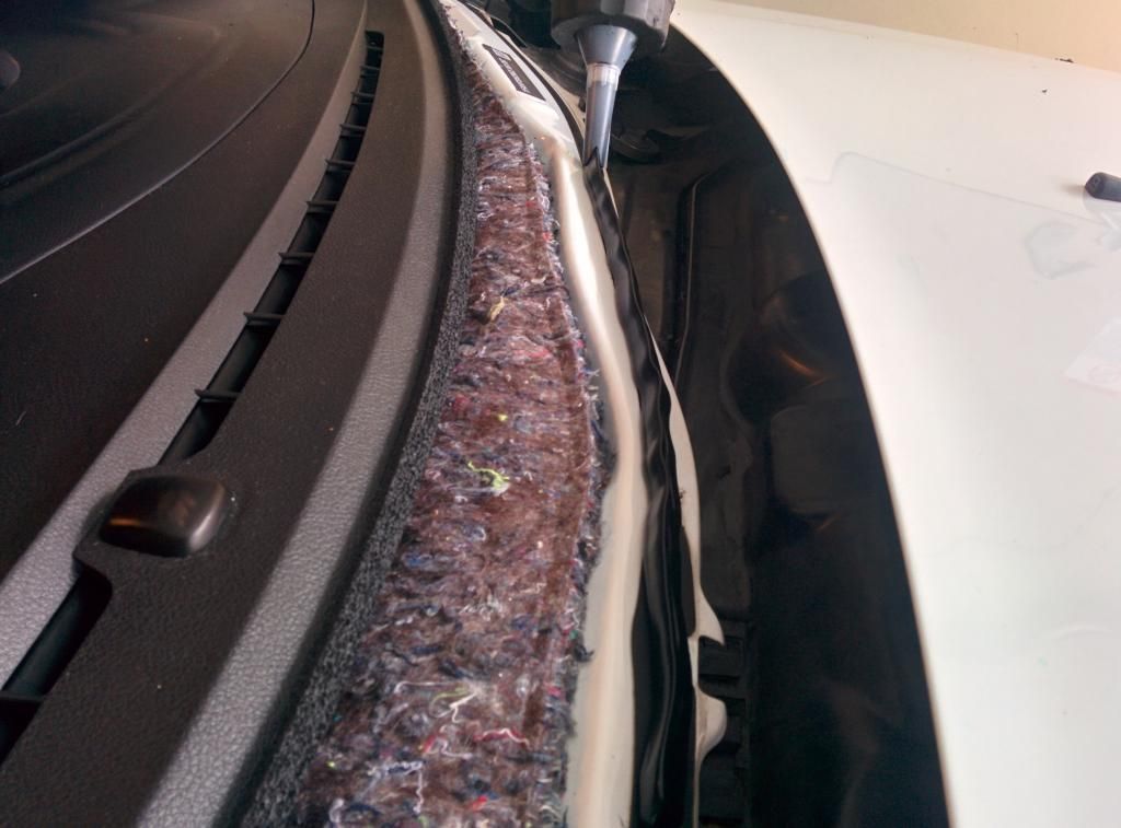

11TH: Applying the new sealant
