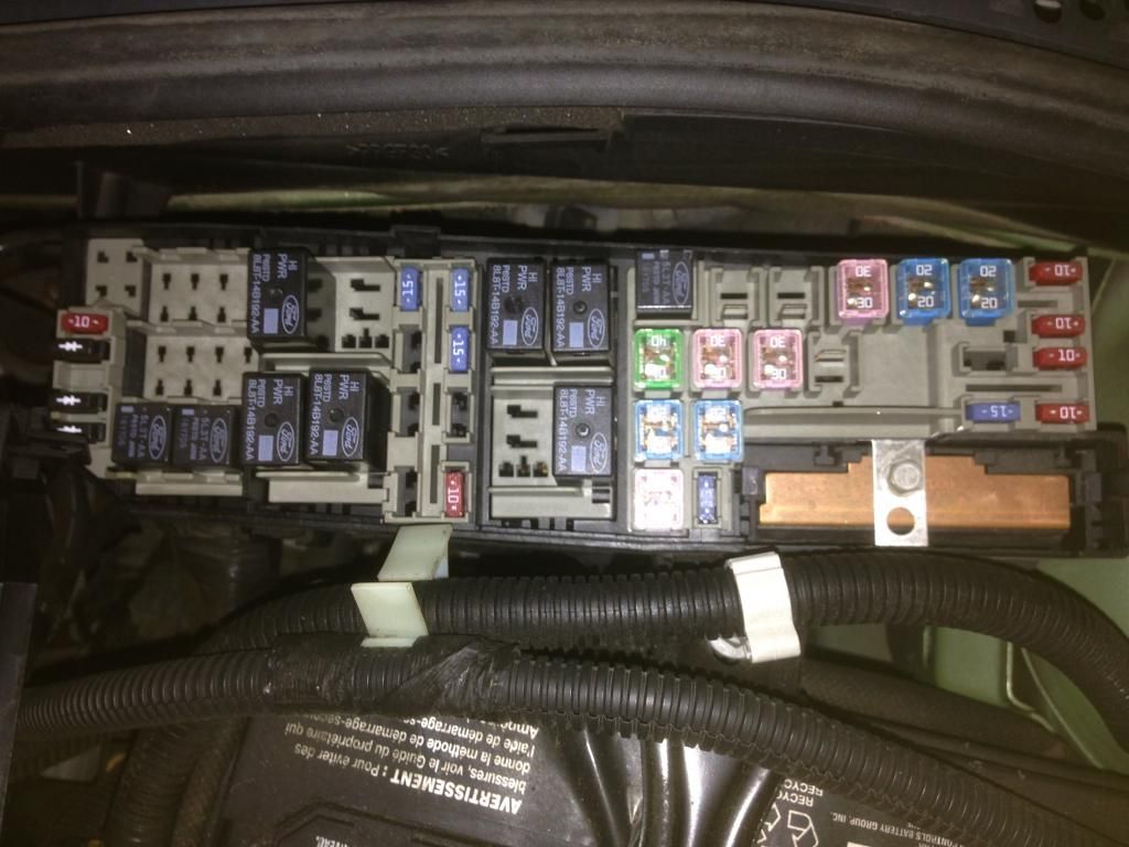

Hello, I'm trying to change the fuel pump on my friends elderly mothers '08 focus. Told her it would take an hour and I spent an over an hour trying to find the fuse for the fuel pump, then ran out of time. Owners manual doesn't reflect what's under the hood. She must have wrong manual.
Any guru's here able to identify the right fuse? I'd rather not do the pax side kick plate method.

#4. Thank you!
Diving into it this afternoon. I don't have the car with me right now, but if I recall, there's a diagram on the fuse box cover that shows me #4. Thx again.
3 Posts
Discussion Starter · #4 ·
Done. For anyone else doing this, the little bolt is 8mm.
Despite pulling the fuse, I still got wet. Doubt there is a way to do it without spilling some. I recommend using the little plugs that are installed on the new filter, to plug the old filter fittings as you are removing it. Wish I'd thought of it before I did it. Hindsight.
Just my two cents.
