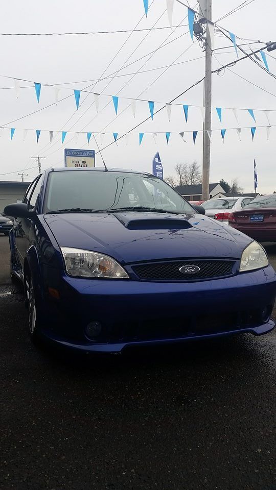

First off I am curious about the stock headlights, I just picked up a ZX5 and noticed the headlights and tail lights have some bulbs out. Could anyone post a picture of stock headlights and taillights? I am not 100% sure if mine are stock.
Also can you change the bulbs without getting new units? Front running light is out along with rear running light.

Yes they are stock. You can replace them without removing the head lights. They take a 9007 headlight bulb. The running lights should be H11 bulbs. Looks like you have a Saleen Focus, very nice ride.
