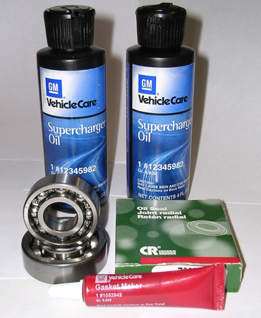

My Jackson racing supercharger on my SVT started to make a horrible noise. It kinda sounded like gravel in the engine. Research online (mainly Pontiac GTP forums) led me to believe that the coupler in the snout was worn out. Also, I learned that if the snout oil seal was leaking oil (it was) that maybe my bearings were dieing too. I ordered up a snout rebuilt kit from http://www.rollingperformance.com/snoutkits.htm
For our SC we need the #STDSNOUTKIT03-V kit (75$). I went with the viton oil seal because they last longer.
I also ordered the coupler #SCCOUPLER for $29.95.
The kit contains both snout bearings, oil seal, gasket, and oil.
If you get it shipped to Canada, see if he will send it in a USPS flat rate box, so you don’t get hit with brokerage at the border like I did.

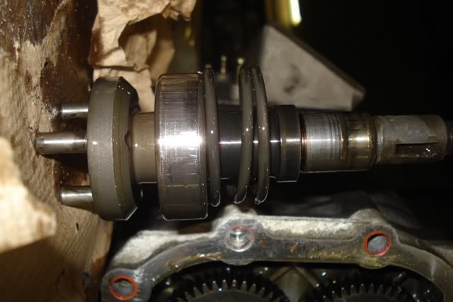

26. Press off the coupler and then the inner bearing.
27. Clean off the shaft to ensure it isn’t damaged or heavily scored. I used brake cleaner on a rag to clean things.
28. Clean off the residual gasket from the snout/rotor housing.
29. Disassembly complete.
30. Now it is possible to take this further and replace the rotor bearings, but mine seemed fine. The rotors turn easily and there is little coating worn off which indicates to me that those bearings are fine.
31. In my case the source of my noise was my pulley. The nut had backed off a bit and my pulley was not running true. This had destroyed my keyway/ key and wrecked the pulley. However I had already ordered the rebuilt kit, so I rebuilt it all anyways while it was disassembled.
