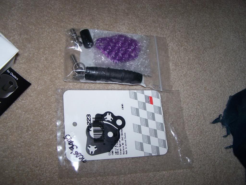

So I just installed the new Massive speed EGR delete plate this past weekend and figured i'd do a write up on it in case anyone has any questions.

Step 4 - Install Massive EGR delete plate
Now that you have everything removed from the head its time to start putting something back on!
-Clean off the gasket mounting surface and bolt the plate to the head using the provided new gasket and new hardware. The gasket and plate can only go on 1 way with the Massive logo facing outwards of course.
Head with EGR valve removed.
Massive EGR plate installed
Step 5 - Install coolant bypass
What you need to do now is quite simple but you have 2 choices. I will tell you both options but the pictures are of my preferred method. The kit comes with everything you need to do either option.
Option 1. plug off the small coolant line you disconnected from the EGR valve with the provided cap. leaving the stock T fitting.
Option 2. (preferred)Remove the stock T fitting from the coolant line and replace it with the provided straight barb. (much cleaner looking in my opinion)
Here is a picture of the stock T fitting removed right next to the coolant hose that has been replaced with the straight barb.
-Reconnect the coolant return hose and the EGR delete is complete, simple as that. Remember to get the car tuned for the EGR delete to kick off your CEL.

I like it. Good read. Where did u get the straight? Size?

You mean the straight barb for the coolant bypass? It comes with the EGR delete kit from Massive. It comes with everything you need.
From K Dog's listing, it seems like the stopper is more so for the 08+ duratecs as they cant swap out the T

You can save a lot of time and money by just taking a NPT tap and tap and plug the 3 holes , very simple , very easy and cost about $1.00 for the 3 plugs
I use to make the egr plate but found tapping the holes much easier

Tom, that's a good idea. But how do you keep the metal filings from getting in the head? Seems like it would be better to do with the head out of the car.
So if I were rebuilding the motor, I'd do it Tom's way. If not, Massive's product looks simple and foolproof.
