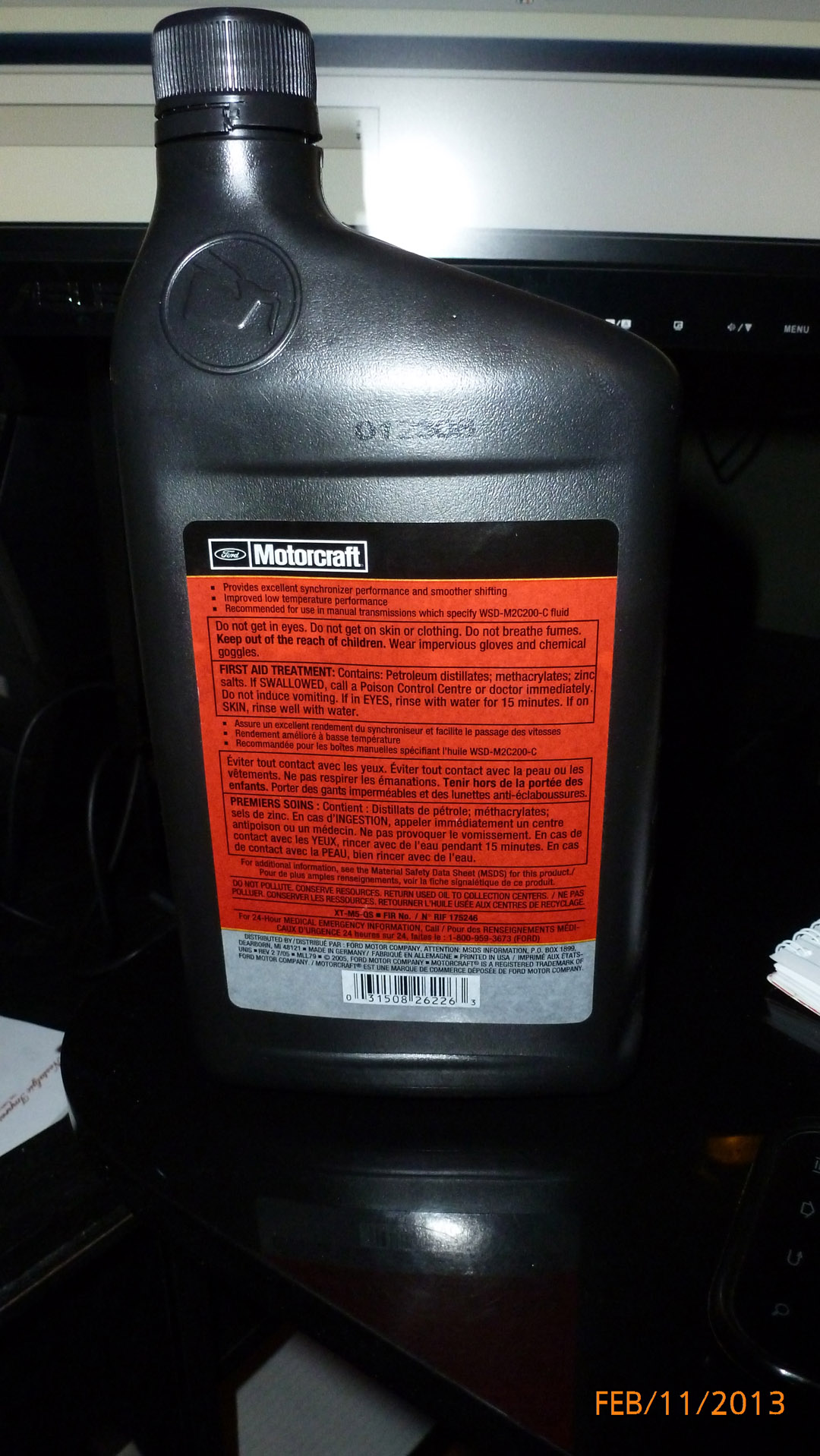

i went with "XT M5 QS" on my cellphone. one guy recognized it, the other didnt.
i saw them type it into their system as "XT.M5.QS" and it came up right away.
i can take a pic of the bottle if you like...

well the guy here tells me its the only one they have, they have another type of tranny fluid but this one costs 45$ a quart, with this number: 1045737
http://www.ebay.co.uk/itm/Multi-vehi...-/190679886573
that stuff...
they cant find xt.m5.qs either...

hope this helps...

yeh they dont have that one available... I guess Im screwed? lol
