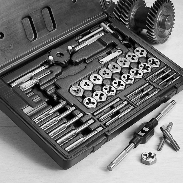

I got a great tap and die kit from sears with everything I'll ever possibly need...
Sunday morning @ 9 starting to work on it and fix the bolt, get larger stud and just use that. I might just get metric studs for the entire manifold. Hopefully I'll bolt the whole assembly back AND receive the gasket I need.

loosen, spray with wd40, and beat the hell out of that exhaust housing with a rubber mallet.
there isnt a 5/8 tap in that set.. i needed one the other day
