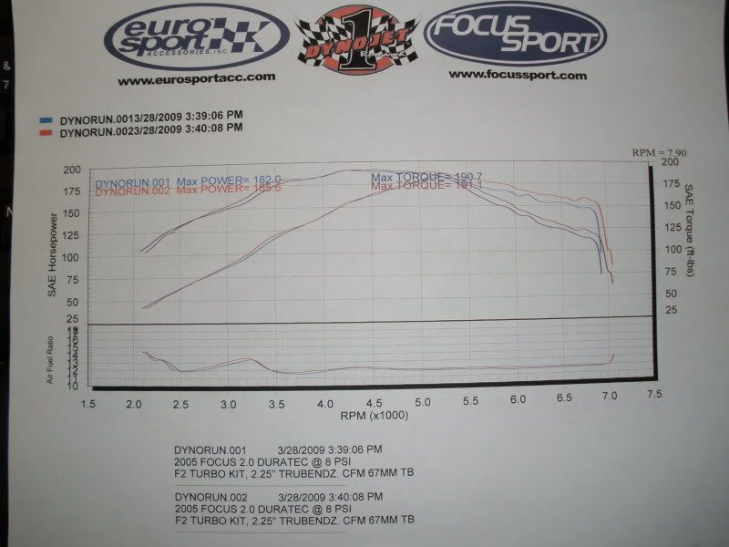

Dyno Information Ė Dynojets
Both vehicles in the graphs have a 2.0L Duratec Manual Transmission and are running 8psi intercooled.
However F2ís kit has a larger throttle body and a 2.25" exhaust and FSWerks kit has the stock throttle body and a 2.5" exhaust.
F2
FSWerks
-------------FSWerks Kit -F2ís Kit ---------------
2300rpms - 63whp 135wtq --- 50whp 125wtq
2800rpms - 90whp 170wtq --- 78whp 145wtq
3300rpms - 125whp 195wtq - 110whp 165wtq
3800rpms - 140whp 195wtq - 130whp 180wtq
4300rpms - 155whp 185wtq - 165whp 191wtq
4800rpms - 173whp 186wtq - 170whp 185wtq
5300rpms - 184whp 184wtq - 182whp 182wtq
5800rpms - 188whp 170wtq - 175whp 157wtq
6300rpms - 190whp 160wtq --162whp 130wtq
6800rpms - 195whp 150wtq --160whp 125wtq
------------ADVANTAGE--------------
2300rpms - FS +13whp +10wtq
2800rpms - FS +12whp +25wtq
3300rpms - FS +15whp +30wtq
3800rpms - FS +10whp +15wtq
4300rpms - F2 +10whp +6wtq
4800rpms - FS +3whp +1wtq
5300rpms - FS +2whp +2wtq
5800rpms - FS +13whp +13wtq
6300rpms - FS+28whp +30wtq
6800rpms - FS +35whp +25wtq
Based on the graphs the peak numbers for both kits are close with FSWerks kit having 10 more whp and 5 more wtq, but the F2 kit takes longer to build to the power and falls off much faster than the FSWerks kit. Also, the A/F on the F2 kit runs a little more lean than the FSWerks kit. Even though FSWerks' A/F numbers aren't listed on this graph, they go from around 12 down to 11-11.5 over the whole rpm range while F2's remain at about 12 til 7k rpms.
-Again remember that the F2 kit has a larger throttle body installed and the FSWerks kit has a 2.5" exhaust compared to 2.25" for the F2.
