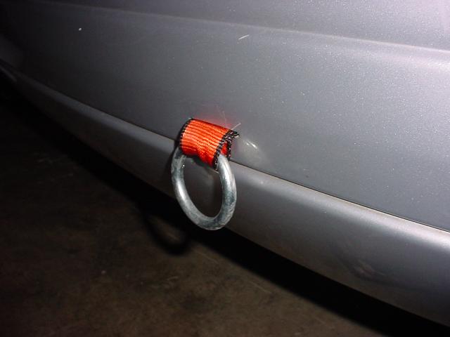

I've always used 'tow straps' on my Focus race cars. They allow for clean bump drafting w/o punching a hole in the other guys bumper like with the solid metal tow hooks. Hopefully you won't be doing any bump drafting on your street car, but it's an option, and you can tuck it behind your bumper cover when not in use.

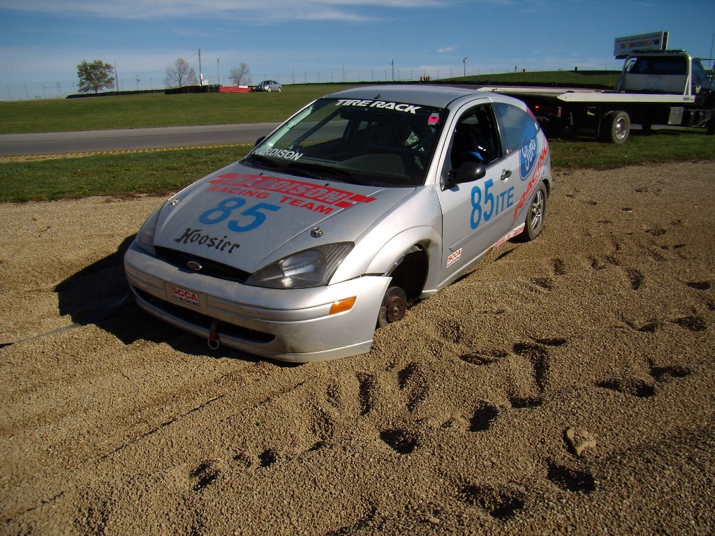

They're strong enough to pull me out of this:
My old SSC Focus:

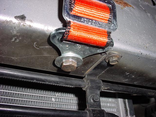

I'll try to get out and take some mounting pics tomorrow, but basically the tow straps are mounted by a single bolt (grade 8). I mounted mine to the steel bumper support behind the bumper cover in the front and the factory tow hook mount in the back. I use the 'hard ring' type strap, but there's also the 'bump draft' type that doesn't have a ring. Search eBay for "SAFEQUIP TOWING STRAP" for pics.

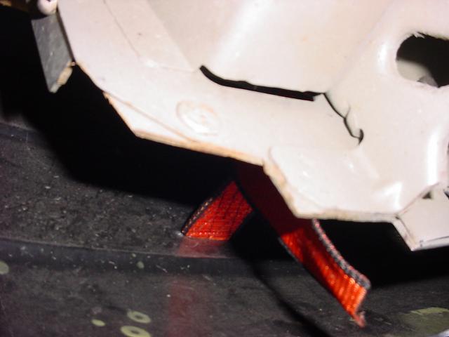

Front strap w/o bumper cover
How front strap is mounted. I drilled a hole up through the bumper brace
Rear tow strap. Make a slight hole in the bumper cover in order to slide the strap through.
Rear tow strap as it comes through the bumper cover
How rear tow strap is mounted to existing bumper bracket/hole
