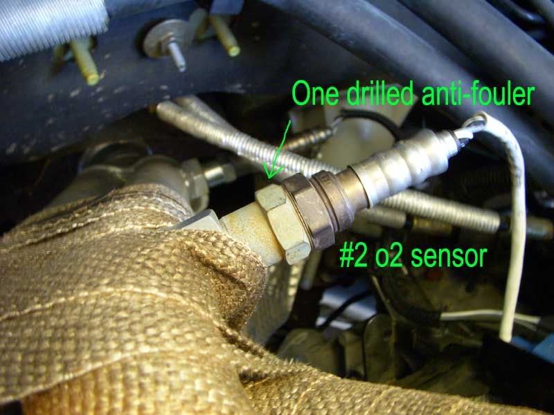

6) Now take the other anti-fouler you drilled and install that on the #2 o2 sensor, using anti-seize. Here's how it should look:
