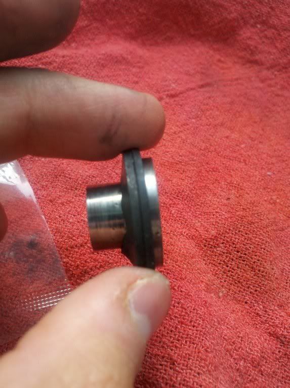

this really did help out a lot...ignore my last comment, I was expecting more of an outcome.
however, to further help eliminate my slop, i added 2 rubber washer to my homemade metal bushing (CNC'd) and there is no slop at all anymore! wonderful feeling with the added STS.
I am not sure if this can be added to the stock plastic bushing or not, but this is what I bought from homedepot
