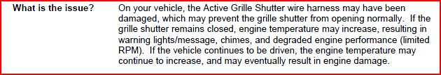

Originally Posted by GhiaFan View Post
Might be worth checking if there is problem with the Active Grille Shutters
Thanks for chiming in with helpful suggestions, guys! The more information, the better.
