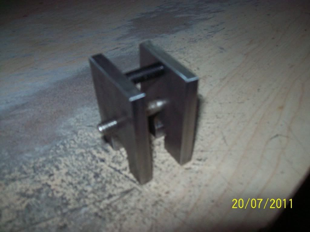

Yea I had that problem too, had to make a flat screw driver bend a certain way to get at it, Then to get it back on, I had to make this, cause it didn't want to go in far enough to get the clip back on.
well, I didn't have to make it, but it did help.
That was as far as I could get it on, before I pressed it together. Kinda weird, I put the tool on there and pressed, then took it off, and the clip went right on by finger.
