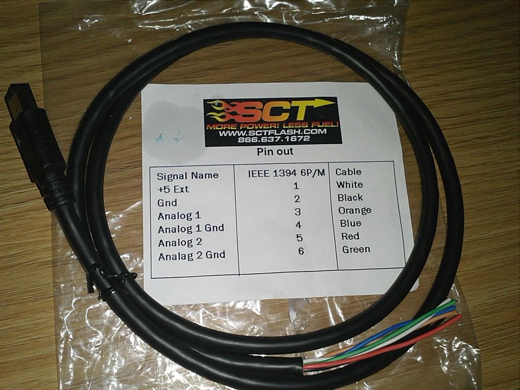

Cool. Yea I just picked this one up cause it already had the wires out for you splice into and a color/pin diagram. I didn't really look much further than that one. Thanks for the info. Save where you can for sure
