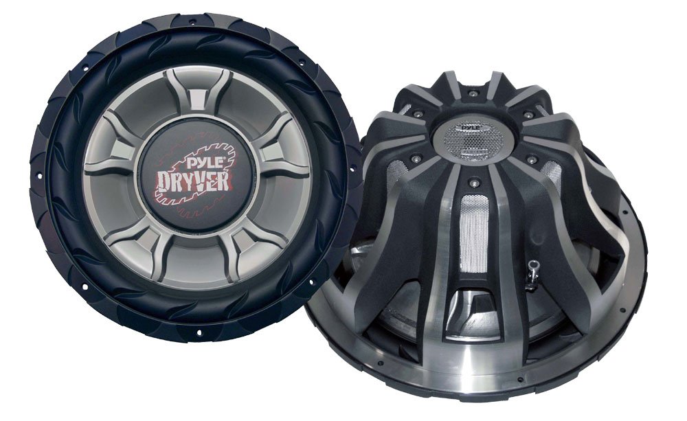

sub:
PYLE PLD15WD 15-Inch 4000 Watt DVC Subwoofer
http://ecx.images-amazon.com/images/...L._SL1000_.jpg
Custom Titanium Moulded Poly Cone 2.5'' 4 Layer Dual Voice Coil Nominal Impedance: Dual 4 Ohms
Custom Grooved Specially Treated Rubber Surround Moulded Plastic Gasket For Sale:20, Qms:5.03, Qes:0.89, Qts:0.66, Vas (Cu ft)8.689
Diamond Cut Aluminum Die-Cast Basket Spring Loaded Wire Connectors SPL: 92 dB
Dual Stacked Magnet Structure 4000 Watts Peak Power Overall Diameter: 16''
Chrome Mesh Magnet Vent Magnet Weight: 2 x 100 oz. Mounting Depth: 6.40''

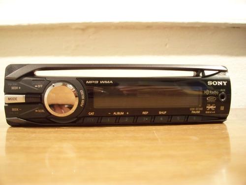

HU:
(not this exact one but an older model)
http://ecx.images-amazon.com/images/I/51pJ5coxHSL.jpg
AM/FM radio, CD, CD-R/RW, MP3/WMA, SAT/HD-ready, iPod-ready receiver
4 x 52 Watts maximum power with 6-channel pre-amp output
Includes front auxiliary input, remote control
