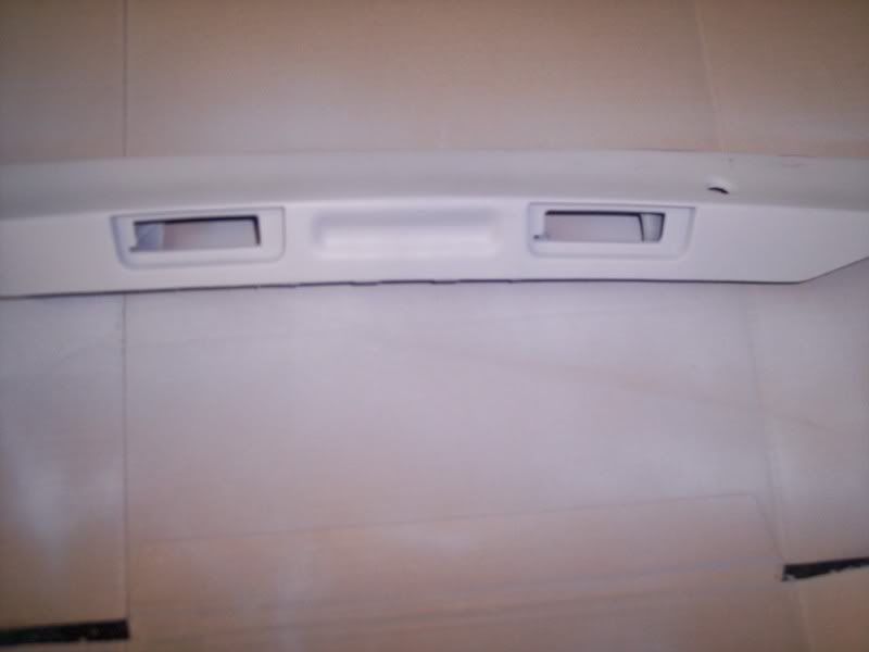

use acetone/alcohol and wipe the entire thing clean and get sand paper and sand it all
dremel the surrounding down (go slow and every so often use the sand paper to smooth it a bit..
BTW::: for those doign this mod please not once you dremel it so its flush with the rest the middle plastic stick will fall off (since you dremel the part its attached) NOTE it doesnt really do anything since the one screw doesnt have it anyways [view pics #2 in "unscrew with 10mm socket" (6th pic listed) to see what i mean by plastic stick]
[once its fully flat and same level as rest of trim there should be 2 quarter size holes]
follow directions on fiberglass kit and place the fiber glass cloth over the holes
(make sure you push cloth into holes and create like a crater)
AFTER the top is dry..i recommend putting some fiberglass behind it (on underside) jsut for extra strength since you will still be sanding more
after that dry [repeat the ^ if necessary] but sand with 80 grit until smooth
then use the body filler and the craters

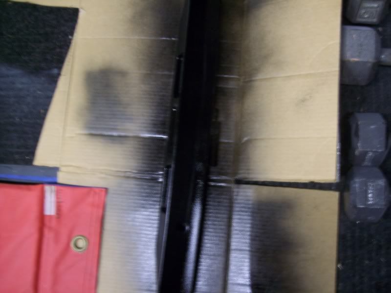

sand with 80 grit.... then prime it all (even under and behind it)
[wet sand and apply a couple coats]
then apply the color paint
then clear coat and use the clear coat sand paper and sand it and re paitn with clear.... wait til its all dry and put lights back and screw back on
